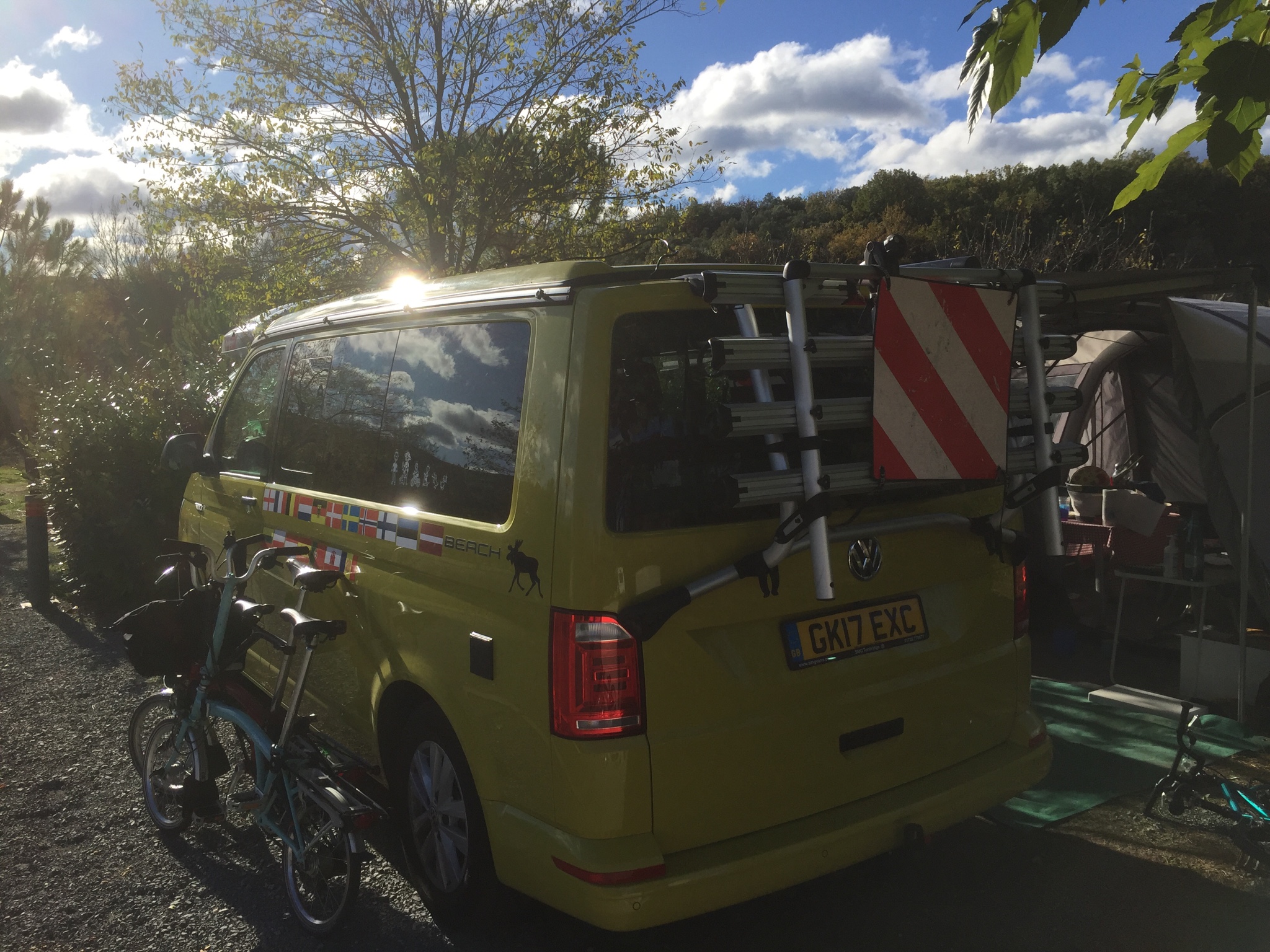

Can anyone advise on the angle of the raised roof when parked on level ground?
The reason I ask is that for only the second time we've managed to drain our leisure battery. We have 200 Watts of solar panels on our roof, but have been parked for three days facing almost due south. The sun here rose to a maximum angle of 28.6' today, and I expect this and the angle of the roof are highly significant factors in our lack of battery power.
The clear implication for us, and anyone else relying on solar charging the leisure battery is to park facing north in winter months - obvious I know, but I'm always one to learn things the hard way.
I'm imagining some GCSE levels maths with the vehicle dimension diagrams to work this one out :Nailbiting
Logic says to park with slope facing south if you have solar panels on it. Not much point having it in the shadow.
Unless in the artic pole region mid summer then face anywhere.
Using vehicle dimensions: 1000mm for the front of the roof, and 320mm for the rear of the roof, and estimating the relevant section of the roof length to be 2500mm, I get 15.8'.
Looking at the roof I guesstimated a quarter of a right angle - i.e. 22.5'. For that to be correct, the relevant roof length would be 1777mm - that is clearly way out.
Assuming the 15.8' to be correct, the sun rose late on my solar panels and set early, striking my panels at just 12.8' at midday.
Parked the other way around, the sun could have hit them all day long at a minimum of 15.8' and almost 45' at midday.

Your pretty close with 15.8. Using a degree bow on this picture gives me roughly 16 degrees.
