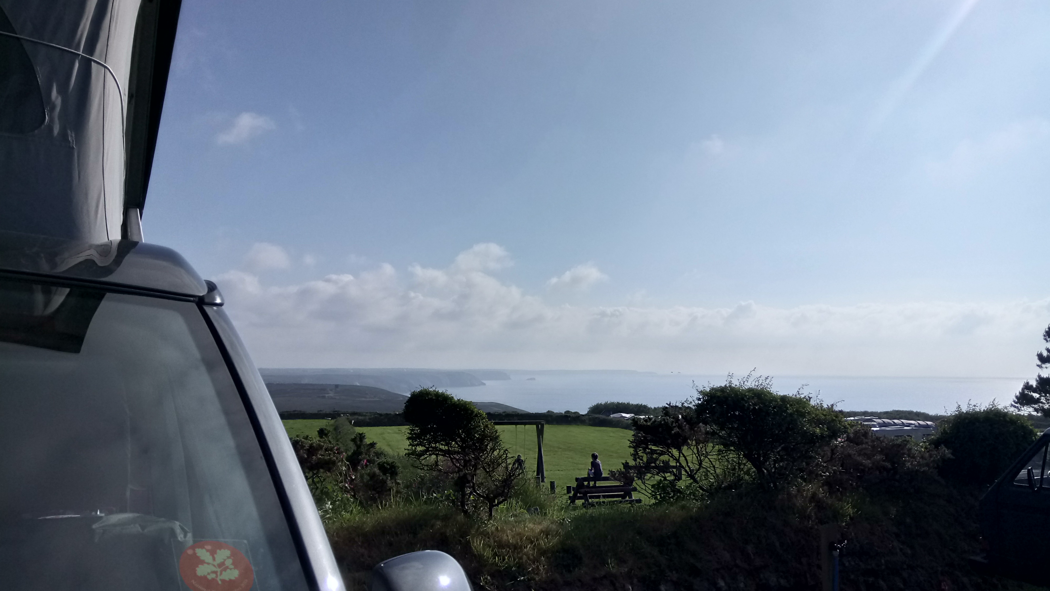

Disaster has struck!.... just when I went to close the roof to head off to a surfing lesson..... now waiting for VW assist to come :(.... it won’t come down - the drivers side goes much slower and seems to jam... and yet when I leave it for 10mins it looks like this... not looking like a good rest of the week... 4 in one bed in an ocean isn’t a great prospect! :headbang

That’s a sad picture

It goes back up ok ish but after 5 mins it slumps again like the picture. If i close it the drivers side goes really slowly and the passenger one races off risking twisting it. The AA guy came and had no knowledge of it so helped me sort out the manual closing which I’ve played with a few times now. The problem that gives is that, because the sides come down at different speeds, then the drivers side won’t go completely flat and seems to foul against something .. so I’ve managed to sort that by putting a sponge ball In the passenger side front to stop it fully closing until the drivers side has caught up then pulled the ball out! ... unconventional but seems to have done the job!.. now lashed down with the tie down kit, nicely demoed in Hotel California’s video.... So where to sleep... and how to get VW to sort quickly... hmmm

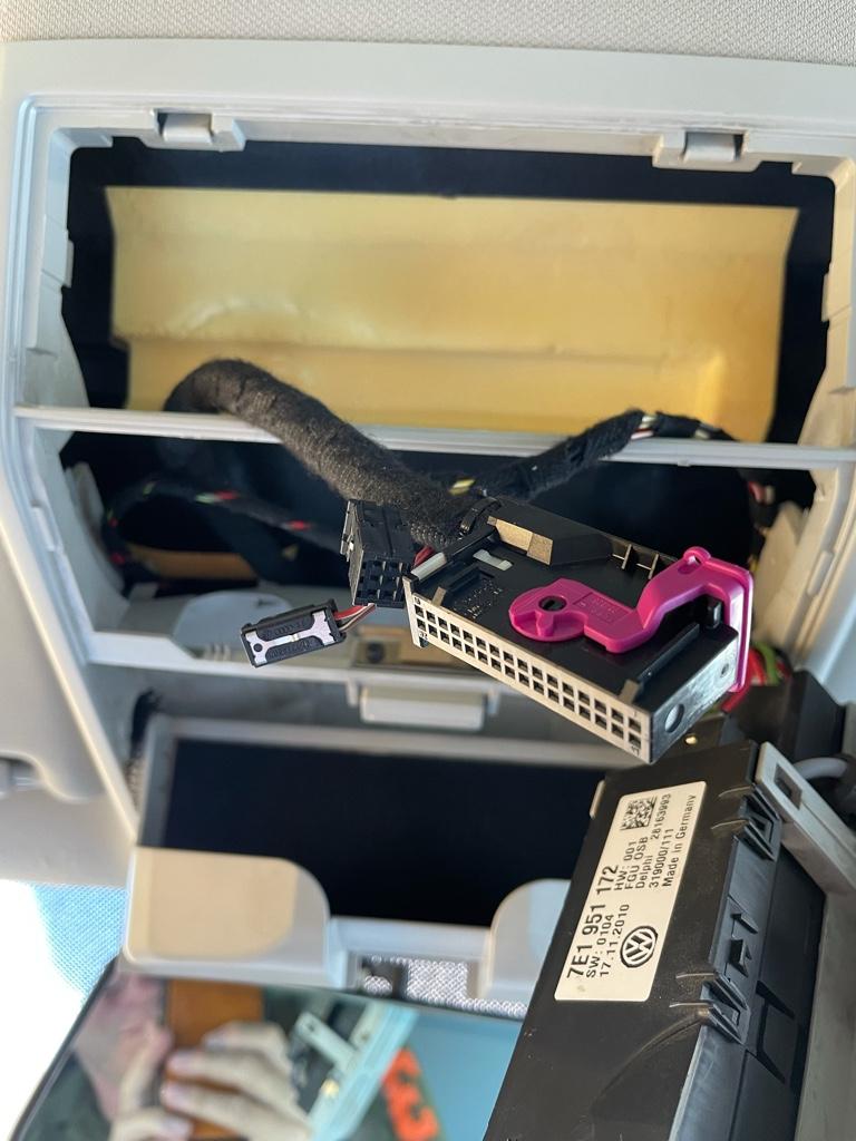

I am expecting this to fail at some point so thought I’d get to grips with the manual closing method. However I can’t see the release screw as I appear to have another panel behind the control panel (which the instruction manual doesn’t show). Has anyone come across this or am I doing something wrong? The control panel was a bit of a pig to remove too.
The light yellow part appears to be some kind of soft cushioning/insulation but is fixed.
The screw is behind that piece of foam. You’ll need to cut a hole in it. I’ll have a look for a photo to show you
Cut away the yellow foam on the R upper quadrant to expose the Screw.

I was hoping it was something like that but as the manual made no reference to it didn’t want to go hacking away before checking. I also didn’t see that post so will go read it!
