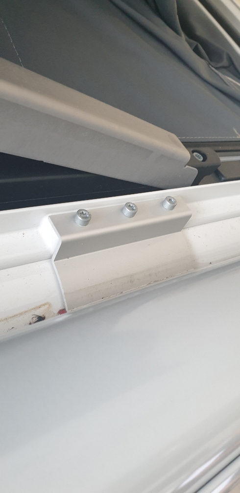

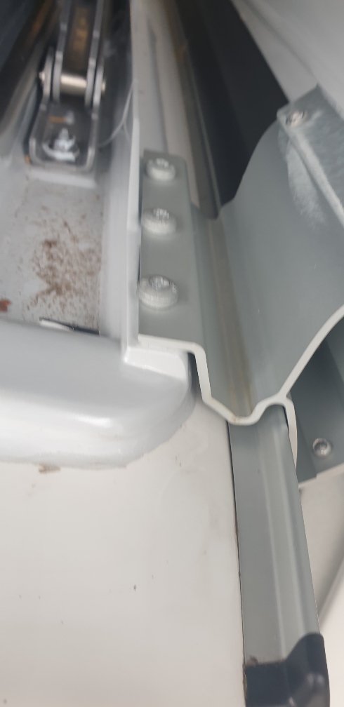

Hi Aussie how did you mount the second awning to the vehicle. Does it just bolt to the gutter rail or did you somehow bolt it to the roof like the drivers side. See the photos on the passenger side doesn't have the nut serts in the roof mouldings and vw say cant buy these parts. Bought a genuine $2500 awning that vw can't fit to my cali any help or photos would be awesome.

I was about to ask the same question. Otherwise they’re relying on a rail that’s only glued to the side of the van to carry the considerable weight of the awning.

Hi Aussie how was it mounted to the roof would be great for some pictures thanks Bushnut
