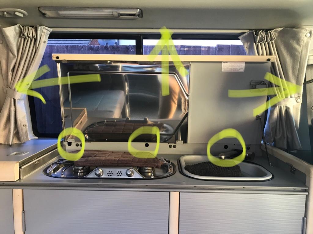

Also, it’s worth noting the window can be removed without having to take out the kitchen. There are three access holes visible along the rear edge of the unit when you lift the lid. It’s a bit nerve racking removing the window retaining nuts as they are out of view but if you’re careful it’s easily dealt with.
Thank you all for getting back. I am really keen to understand on how it can be removed without taking the kitchen out as I can source a full new window no problem. I have been looking this afternoon for the access holes and for the life of me I can’t see them. Could I bee cheeky and ask if you could take a photo to point out where they are as I am a little slow when it comes to things like this. And thanks again
Just had another look and I’ve got the access holes! Germans... thought of everything, love their engineering thinking. And I take. The other bolts are behind the panels, which just lift out all around the top and sides?
You got it…
