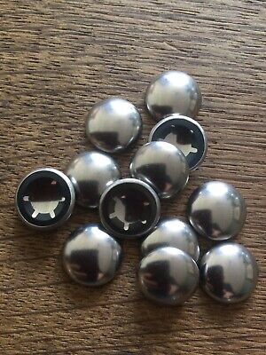

After using our slide out table (2019 Ocean 6) we couldn't collapse the table leg which normally 'snaps' into position ready to slide and lock into position so we can set off home. Had a look and appears the top of the bolt has sheered off (see photos which might help to explain better) so that the spring mechanism prevented it from snapping into position. We managed to get home by jamming the table, to avoid it banging away whilst driving.
First picture shows where the bolt head is missing/sheered off. Second picture is the other side, and I am guessing, how it should be?

That is not a bolt head but a push on cap. It is held on with the pressure of sprung metal that grips in to the rod it is attached to.
They are called starlock caps.
Check these out on ebay - assuming that teh rod size is 6mm diameter. There are other sizes whould you need smaller or larger.

After measuring the diameter I thought it was nearer 5mm but it maybe 6mm - its hard to tell. I ordered some from this eBay seller (I couldn't find them anywhere else) - https://www.ebay.co.uk/itm/233521443534
Arrived today and fitted one - kept the rest as spares. Quite a tight fit, using some pliers to get them on - but I guess they have to be a tight fit to secure the bolt as it is sprung as part of the table mechanism. Table seems to be fine now, fingers crossed!
