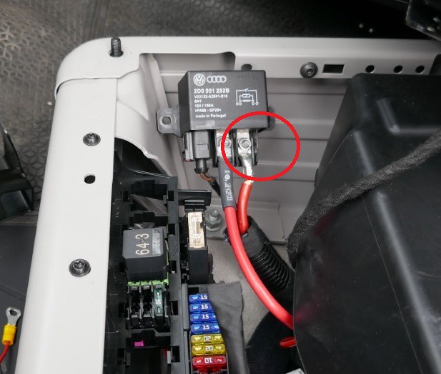

There is a relay under the passenger seat that is energised when the engine is running, connecting the starter battery to the leissure battery/s so they are charged whilst the engine runs.
In my solar charger instructions specifically for the WRM15 dual battery charger I advise connecting to the right terminal of the relay, which is normally starter battery live (permanent). No isses until now.
One customer found the wire on the right to only become live when the engine is running, which doesn't make a whole lot of sense when you think how the relay is supposed to work. (image below of the relay and the terminal circled).
Has anyone else found this to be the case? The only thing I can think is another relay has been added elsewhere, before this relay?
My customer found another SB live near by and very helpfully sent me the photos , so there is an easy solution, but I'd like to know if this is a one off, or VW changed something! The way split charging relays work it makes no sense at all!
That suggests to me that they have blown the 100A supply fuse in the E box under the battery.
Aha - that makes sense - tell me more about the 100A fuse and the "E" box?
Is there some kind of fuse box under the battery when you lift it out?
The 80A fuse is next to (After) the relay the 100A fuse is on the other end of the supply to that relay and is here; Third from the left. I replaced one for a member with the same issue.
Cheers, what's the location of the box pictured above?
So you are saying there is a 80 Fuse near the relay? sitting between the relay and the SB , and there is then the 100A fuse, again, between the relay and the SB, but in the box above?
Sorry for all the questions, I don't know much under the bonnet as I never go thhere.
You have to remove the battery then undo the screws for the cover below.
Its the 100A fuse circled here.
That 100A fuse is in the box labled main fuses in this drawing.
Nice one, thanks!
So the fuse box you have pictured is under the starter battery, and that's where the 100amp fuse is. Got it.
The 80 amp fuse comes off the relay under the passanger seat and should just be a simple case of following the wire to find it.
You are a star. Thanks! p.s. what software adds the nice speech bubbles / labels.
