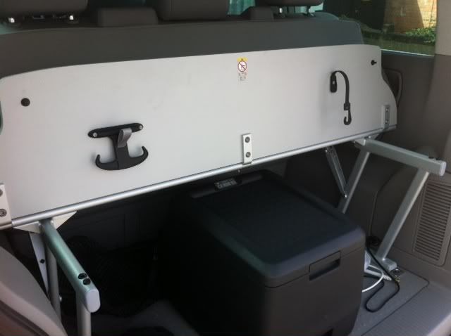

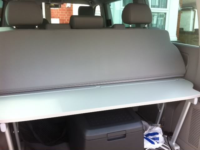

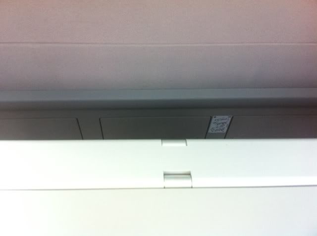

Hopefully these pictures will explain and maybe, by just buying the board you will get some increased practicality.
This shows that in the three seater is hinged so it can be moved/manipulated and folded.
Like this...
Or if you had two additional seats you can drop the back part and push the seat back giving your passengers more room
Not a great photo but you can see the gap now the front part of the board is dropped. You can now push the seat further back but still keep the board and turn it into bed if you wanted to travel with extra seats.
Hope this helps
