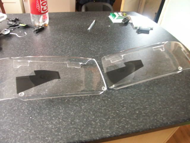

Just a tip if you are fitting these for protection or going abroad.
We had one fly off and hit the bonnet a while ago and checking them over the fit is very loose.
The top metal securing strap doen't have enough adjustment to pull the covers tight so the solution is to slightly elongate the slot in the cover downwards. This then enables the strap to be adjusted to hold the covers firmly.

Both or either.
The plastic covers can be used just to protect your headlights from damage from flying stones etc.
But they also come with black sticky patches and appropriate markings to allow you to blank off the dazzling part of our UK headlight when abroad.
I guess they are available on mainland Europe with patches for UK road use too.

Yes, just like that.
The retaining strap with the slot which needs to be elongated downwards.

I tried that on our first trip to France in the Cali and failed dismally.
When headlight had prisms molded into the glass lens that did the beam shaping, then I always used 'sticky backed plastic' (sorry, that is a reference to a BBC children's TV show) to cover the parts of the beam that upset oncoming traffic on the continent.
But now the glass is plain, all the beam shaping is done by the reflector and so makes masking it much more difficult. Hence the posh solution.
