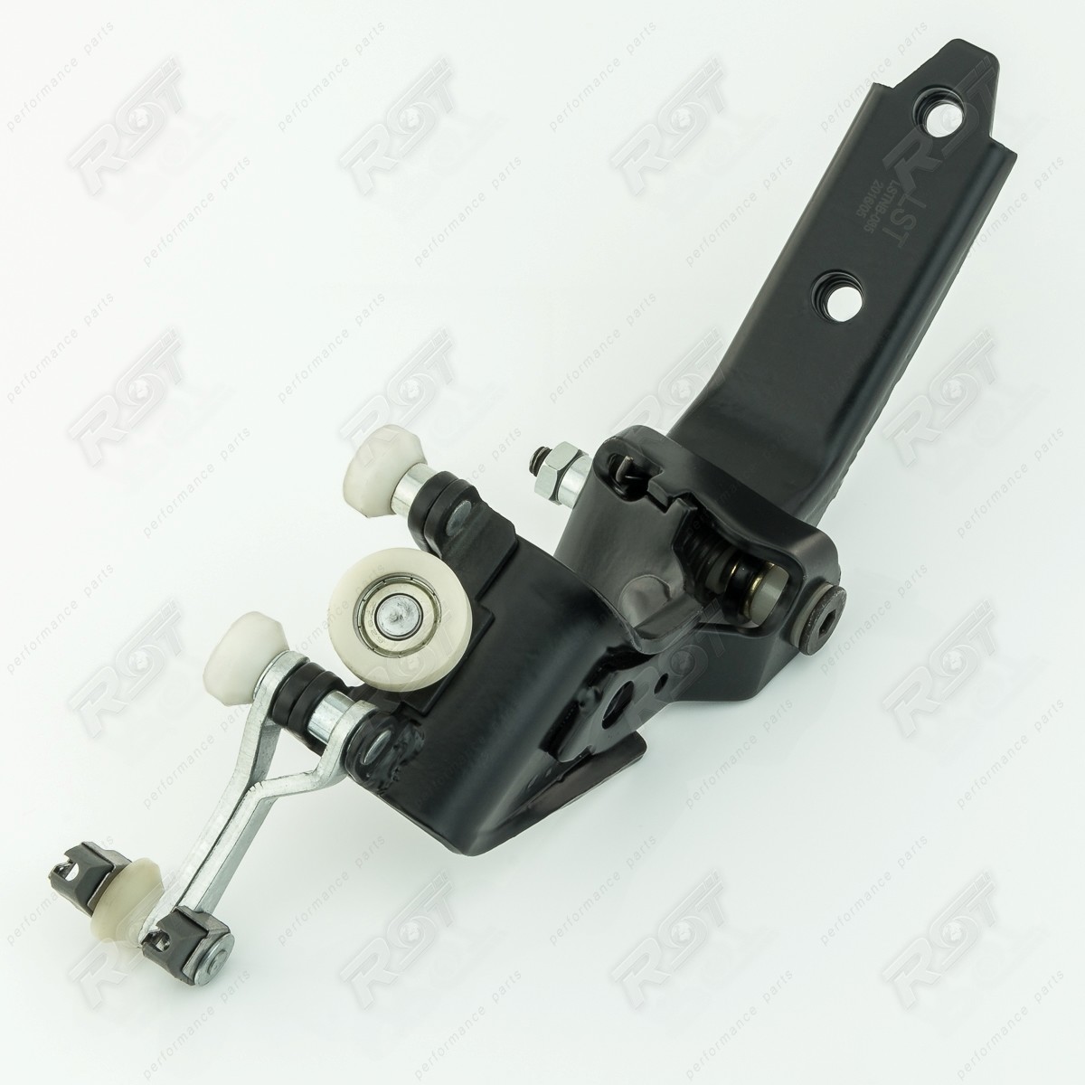

There seems to be a large amount of play in the middle roller bracket, is this normal? I think the 2 horizontal rollers might have worn down which is now allowing this play in the bracket. This could be causing the bracket to be closer to the bodywork hence the rub as it goes round the corner.
It's hard to get a picture of the roller as it is inside the bracket. If you look at the video below, you can see the vertical roller in the middle has white plastic on it whereas the two horizontal rollers the entire white plastic part has worn away down to the metal core.
Possibly need this or similar?
Clips breaking is normal happens all the time the rollers do ware but also check the guide the m5 securing bolts have a habit of coming loose causing the whole assembly to drop and create the damage

I'm having a bit of trouble locating a part number for the door hinge. Concurring with VW Guru, I think the rollers on this hinge have worn down which has caused the hinge to drop slightly causing the rubbing on the bodywork so I am going to replace it. I haven't wanted to take it off to inspect it because to keep the van secure, I'll have to put everything back together whilst I wait for the replacement parts to arrive.

Hi the sliding door hinge roller on the electric door is not a separate piece like the manual door. it actually comes complete with a new guide rail as the wires are built in so look up the roller guide for electric door.
Right, I see so that’s why it’s so expensive then.
Do you know whether it is possible to remove the hinge and just replace the rollers? I have seen replacement rollers on eBay but without taking the hinge off can’t see whether they are removable or not.

To be honest I don’t know I normally just replace the whole unit but I changed one a couple of weeks ago and the old part is at work I can have a look in the morning and let you know.
Yeah if you wouldn’t mind that would be brilliant. The replacement rollers are £10 so if it saves buying a whole new unit for £450 it’s a no brainer!
Hi so I have had a look this morning and as you can see from the pictures below the metal pins which ho through the body of the roller are Peened over, looking at the picture you added earlier in the thread it looks like they will fit. You will have to drill the old ones out and then peen over the ends of the new ones and you should be all good EFA42111-1B90-424D-807E-7F536B29FEE9.jpeg BEF00377-7247-4269-A832-1FC56303420D.jpeg
I have just discovered I have the same issue. Electric roller is slightly different as you can see.
