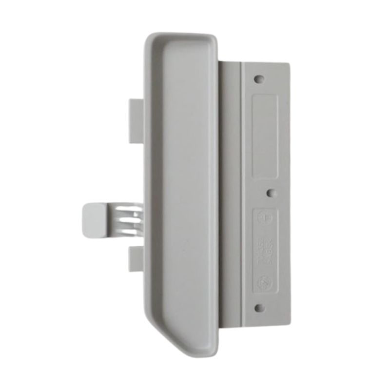

The left hand kitchen door handle split close to where it is screwed to the door and eventually broke off completely. Is this common on T6.1s ?

Ordered a replacement but having found the broken off piece am giving a repair a go with dollop of Araldite :)

Yes you can @tobyprivett .
There are 3 Torx screws to undo as per my first picture. You have to work by touch but it’s not too fiddly. When reassembling I screwed the screws back into the plastic first and then replaced the unit and tightened them up. The profile of the ‘handle’ means that everything just lines up. Easy job.
There are only 3 small Allen screws holding it on. If you like to see what you’re doing take out the cupboard shelf, lie along the backseat and put your head and a shoulder inside the cupboard, easier for a small lad or lass.
We had a broken handle on a demo van we hired from a VW van centre 2 years ago. The chap who dealt with us sad that this, plus the table stowage latch, tend to be the most common breakages. The LH cupboard handle gets impacted by the RH door when you open it too harshly and it impacts on the other handle. Knowing this, we’ve been treating our van with a ‘light touch ‘.

Could be worth putting some sticky backed foam on the R hand door edge to cushion the impact on the catch.
Good shout I’ll take a look. The RH door basically acts like a guillotine ! It should be designed with a door stop really. It can’t be anything too thick though, as the door has to be fully open for the cutlery drawer to pull out.
Maybe a screw, or even a lump of BlueTac in the slider.
