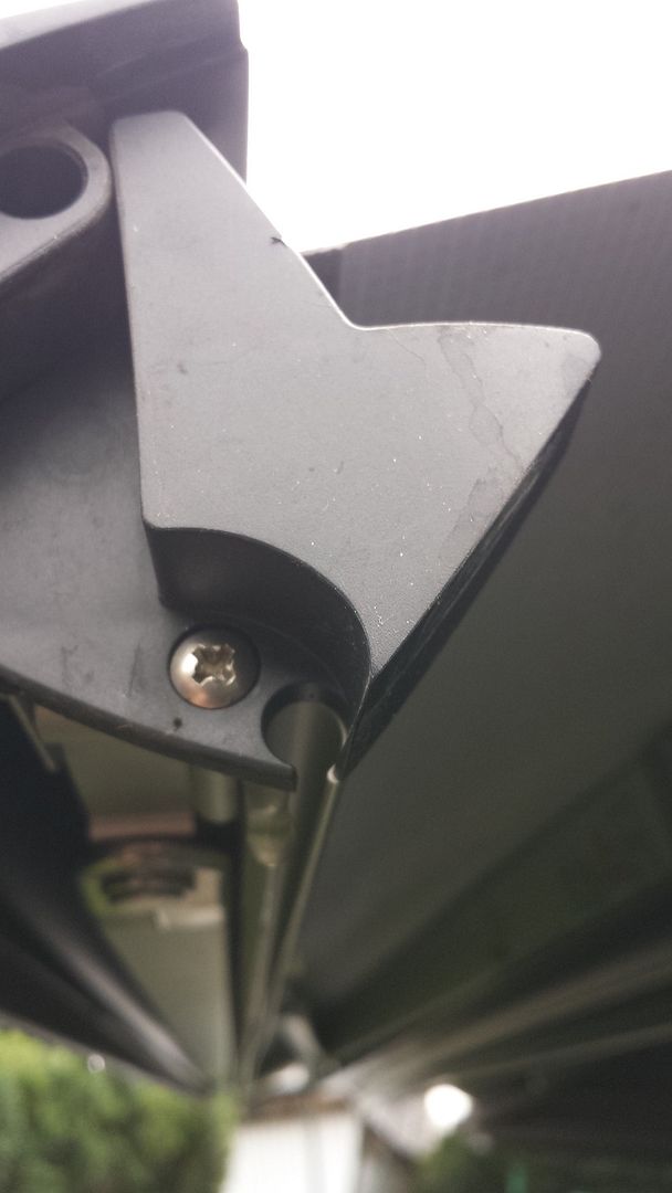

I know there is a geek here that can help me a money me a lot of trial and error time I have a new T6 Oean with the VW fitted awning. I have also purchased an Vango Air Beam awning. Does anyone know the best way of connecting the Vango to the camper without removing the factory fitted wind out awning from the van?
Think there are strips ( kador- strips? ) that slide in the awning and other side in the tent....

Thanks everyone, looked at that kit but must have missed something. Didn't see how this connects to the van awning
As @snowy55 says, you need to roll the awing out a few inches, this will reveal the awning channel, the Kador slides in here.

The AirAway comes fitted with a 6mm kador strip. This can be slid directly into a kador rail on the vehicle but Vango recommends using figure eight strips and an extra kador adaptor (sold separately) to ensure the kador fits snuggly and to provide flexibility when driving the vehicle away whilst the AirAway is pitched.
They are suggesting using a figure of 8 and another kador strip.
What's the downside of just sliding the 6mm kador from the awning straight into the kador slot on the van?
Is the additional figure of 8 just to make driving away easier? Any other upsides? If you weren't planning on driving away I'm guessing you won't need to do this.
The main reason for the fig of 8 is easy disconnection of the awning, if you just use kador on its own it could end up being quite time consuming each time you connect/disconnest the drive away awning.
Also some 6mm kador is too thick to go into the awning channel on the Cali, that why we recommend 4mm

should it not be 6mm to 6mm??
Martin's post above said that 6mm is too big for the Cali rail
He said "some 6mm kador is too thick to go into the awning channel on the Cali"
The channel is sized for 6mm but I have found that if the end pieces of the rail are not exactly aligned with the main channel then it can take a bit of wiggling to get 6mm kador in.
There is an alternative way to connect the awning to the van.
The figure of eight will simply slot onto the top edge of the roll out awning if you have one.
This shows the principle. It also raises the drive away awning up and is far easier than threading kador strips. The kador strip method is also shown so you can see the height difference.
