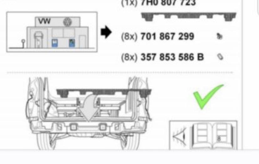

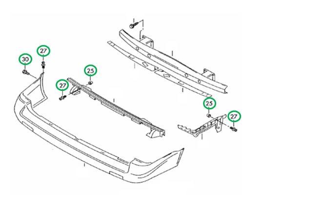

Does anyone know what this bumper support looks like if I try and check? I’m loathed to order the parts from VW if it’s already on there! PF Jones told me I need it.
I’d say it’s pretty likely that you have it. Other forums posts suggest that any t6 with a window behind the driver has it but panel vans don’t. I’ve attached pics of what it looks like and in the second pic are the VW part numbers for 1 support , 8 screws and 8 grommits. Get your head underneath the bumper and you can see it if it’s there.
