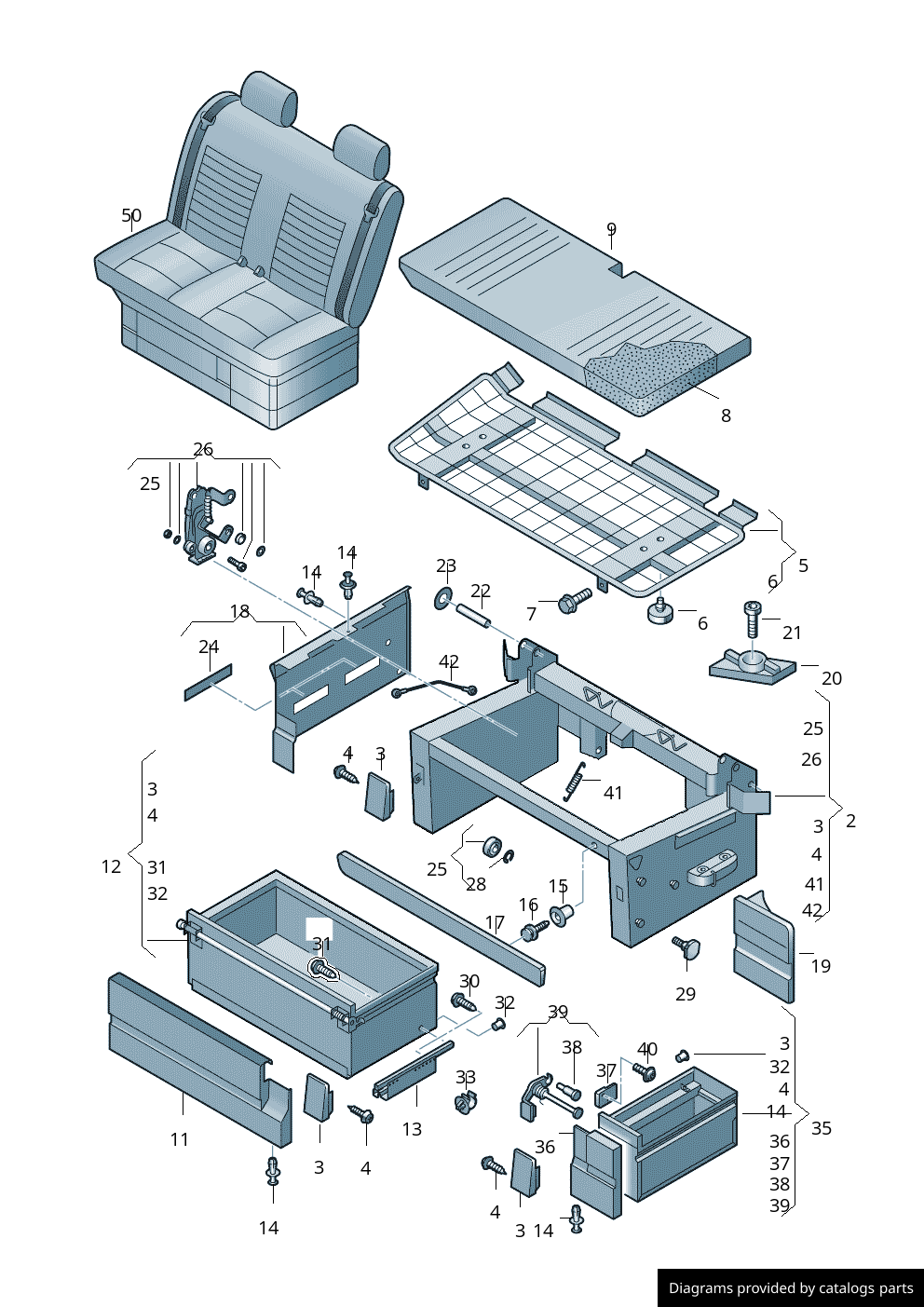

The mystery spring looks very similar to the tensioning spring no. 41 in post #7.
Hard to figure out what it is tensioning. Could be something to do with the release handle.
