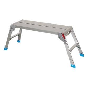

Our tandem triplet bicycle isn’t far off that weight, and I manage just fine on my own getting it on or off. But I do need to prepare carefully before hand with our plasterers’ platform.
Amazing - thanks for this!
