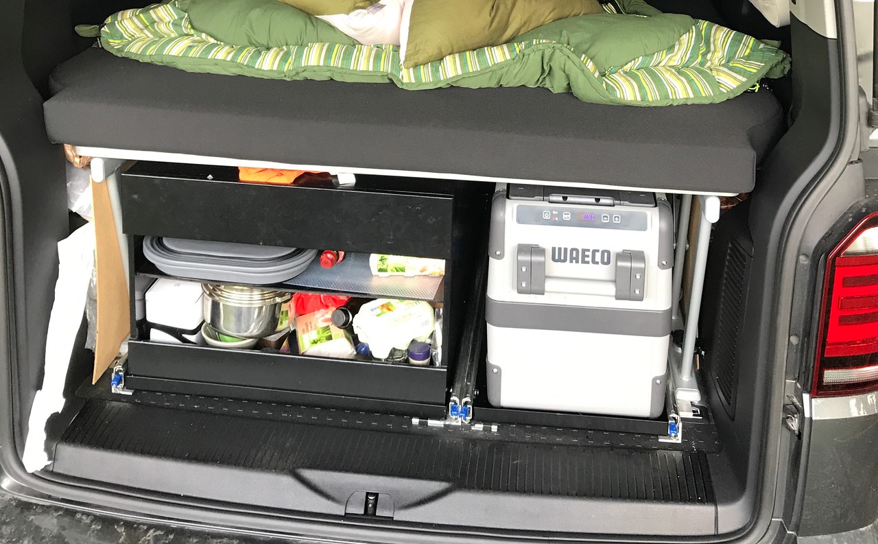

We have the CFX28, fits just fine. I think I would add a smaller fridge to use between front seats before buying an even larger one. Here is the CFX28 on one of the drawers. We have two, one that is the exact width of the fridge and the other as wide as possible.
We have a small kitchen module where we keep all kitchen stuff next to the fridge:
Thanks Kave,
The CFX 28 looks like a very good fit. As there is usually just the two of us camping, the CFX 28 would be ideal. My original idea was to buy the 38 litre version however whilst I don't know for sure, that version may take up too much valuable space and also be too tall to store on the pull out tray.
Very interesting photograph. Why did you decide to go for two separate pull out trays instead of one big one? Can I ask, where you purchased them or did you make them up yourself?

Thanks Kave,
Many thanks
Paul
I made them myself, I just followed this "http://bau-ich-mir-selbst.de/selbstbauanregung-heckauszug-fuer-vw-t5-t6-california-multivan-2/"
The the fridge stands really well by its own in it's own drawer.
Sometimes I like to grab something in the back (1m long) it's easier than if it was just one drawer.
