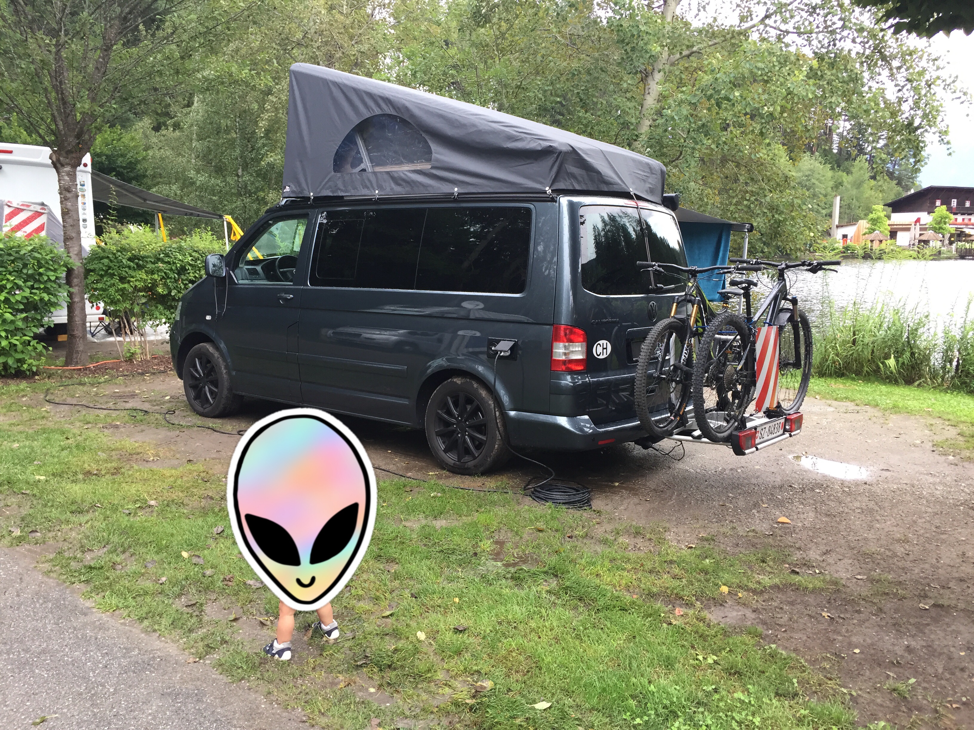

I've also got the Altera Stada DL3 and must say that I'm very pleased. If you avoid using the first slot for an adult bike it allows full access to tailgate.
Hi there
We have a VW factory fitted fixed towbar and use the Atera Srada DL3.No problem. The tailgate clears the handlebars and it is simple to use. No contest.
If you have extra wide handlebars you might have a problem. My only tip is not to overtighten the quick release clamps on the vertical part of the frame. If they are too tight the tilt mechanism may not operate correctly.
