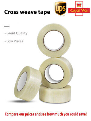

This is a common problem and I remember reading on this forum that the recommended repair tape is filament tape .. shown in pic. I have some and it works very well indeed. when the weather is hot, the supplied tape peels off and this is what you use to put it all back together again.
I am on my second replaced door and now too scared to shut it!! Thanks for this I will get a roll ordered for a belt and braces approach!!
Like many others, we have had issues with both tambour doors breaking apart, and have tried many things to fix them......
I replaced the wardrobe door with complete replacement. Cost was about £220. I have kept the old parts as a spare, now reassembled and reinforced with the reinforced tape detailed below.
The rear cupboard door split apart at one of the seams. I used super glue and duct tape. But this only lasted 1 season.
Having tried different duct tape brands, I came to the conclusion that this type is not ideal when the joints are continually being expanded and contracted through careful opening and closing. Whereas the original VW clear and reinforced tape did. So after some searching I have found this tape and it works a treat.

Ours is either as fitted or has been reinforced with tape that has threads in it which seems really effective. Like the idea of silicone spray mentioned above by several commenters as ours is very stiff on our new van (nee to us) and having rented ocean Calis before Id say this is a perennial issue!!

Update.
Crossweave tape arrived, took of end pieces and easily slid the handle piece back in. Added 4 lines of tape all the way across the tambour door. Seems quite a good strong fix. Will source some silicone spray and use on both doors.
Thank you all for your areas and know how.
