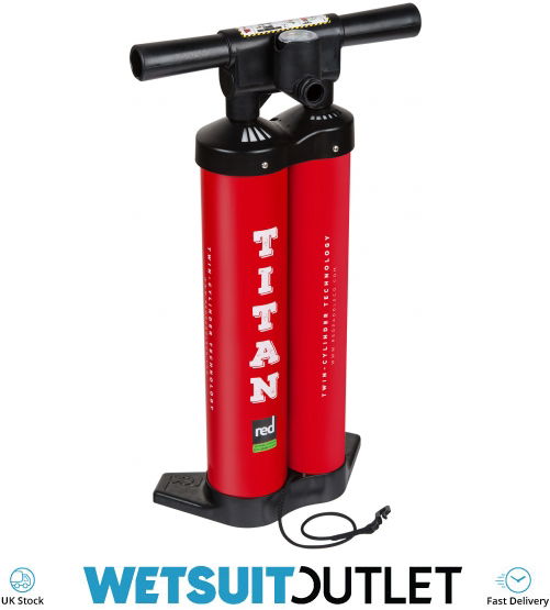

You will most probably cause the ring pump to overheat / cut out as it’s not designed for large volume. You would need an electric SUP pump for the volume, but always keep your engine running otherwise will drain battery:
We use a manual Double barrelled SUP pump (as we also have SUP’s), but they are quite bulky to store:
