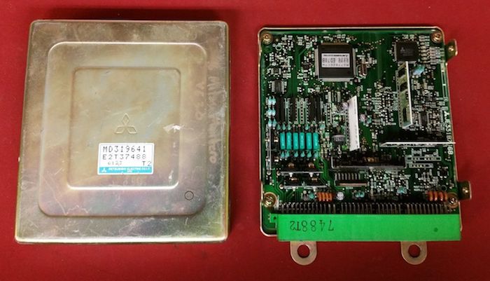

the fault codes you listed appear to be very generic, relating to the PCM power control module), which is another reason why the dealer is probably reluctant to investigate further As this type of fault applies to a non serviceable item.
all I can suggest is you log the fault with the dealer formally in writing and state that you believe the PCM is faulty ( intermittent), ask them to reflash (reprogram) the PCM and should the problem occur again that you wish for the faulty PCM to be replaced (as would be normal practice in diagnosis & resolving an intermittent issue with a non serviceable component). Should it ever re occur you have written proof that is has occurred before which puts you in a stronger position to press for a replacement PCM / Ecu
Volkswagen Transporter P0606: ECM/PCM → Processor Fault | Drivetrain Resource
P0606 is a generic OBD II code. Which means that it has the same meaning for the Volkswagen Transporter that it would for any other vehicle. If your Transporter has P0606 it's highly likely that the ECM/PCM (engine or powertrain control module, they mean the same thing) has failed. The PCM...www.700r4transmissionhq.com
