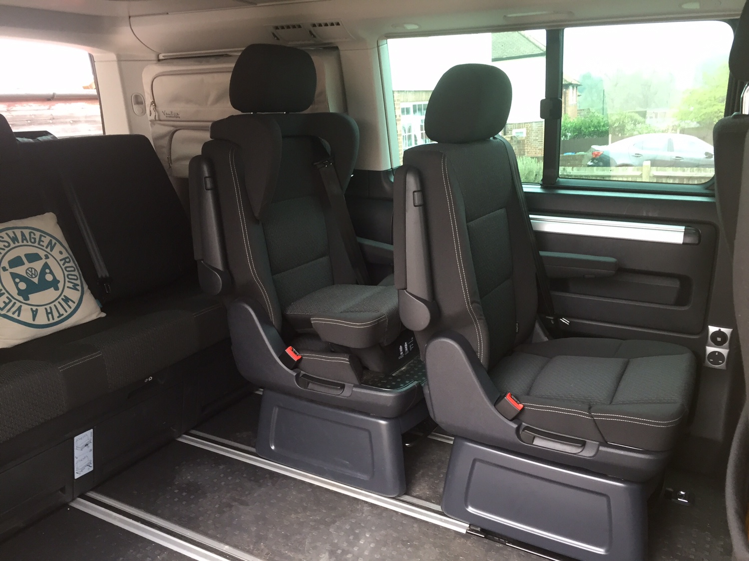

After awkward loading of aging in-laws over Christmas with the 5th seat in it's 'proper' place blocking the door of our Beach (2 seater bench) I tried the centre slots.
The stop needs removing before this works, but the result is far better, with the door clear and a little more leg room.
This photograph is before I had put the rail covers back on.​
