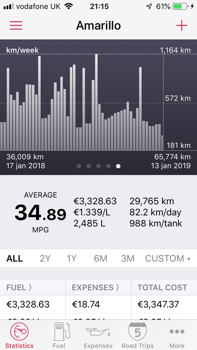

I have the 80L tank and over the past 35 refuels have averaged 614 miles per tank.

There are two different but related matters being discussed in this thread: brim to brim MPG measurements and 80L vs 70L tank range.
