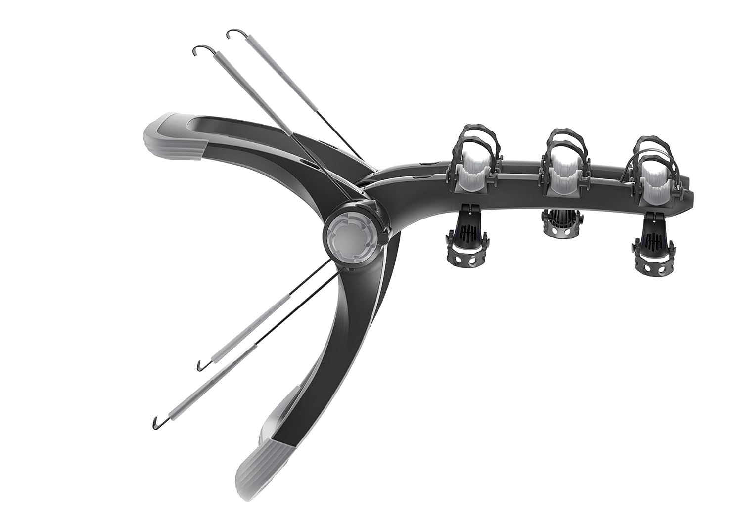

Just back from 3,000km with one of these on the back, with three bikes loaded:
https://www.amazon.co.uk/gp/product/B00T7Q7HG8/?tag=eliteelect-21
Pros
  • Cheap
  • Removeable
  • Top of the bikes remain under roof height
  • Doesn't foul camera or parking sensors
  • Can lift the tailgate with roof either up or down
  • Folds down almost flat against the tailgate
  • Didn't leave any marks at all (I used little swatches of chamois at the four touch points)
  • Built in lock useful
Cons
  • Lighter-duty than the more permanent carriers
  • Can be tight fitting smaller bikes
  • One of the straps broke
  • The down-tube holders are a bit flimsy (but seem to do the job)
I had read somewhere that a Cali driver had issues with side slip but I think they just hadn't fitted theirs properly. The ratchet mechanism is well designed and engineered.
Overall I'm happy. It lives off the van most of the time, and gets used on the other-half's Jazz regularly too.
Cheers.
This looks like a copy of the (much cheaper) Saris Bones 3 that's been around for about 15 years - I've got one that I used to use on my car... Good bit kit that has fitted every vehicle I've owned (except the van as it has a rear spoiler)
https://www.tredz.co.uk/.Saris-Bone...TCRrWA2BhopsaUr7_-eoHqTB6bUWTo-0aAp3rEALw_wcB
Pros
  • Cheap
  • Removeable
Cons
Cheers.
