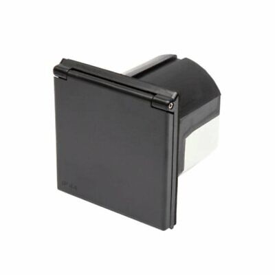

This old merged thread is a disjointed mess but it did lead me to the hook up socket on eBay after ours started flapping. We have extended warranty but getting anything done requires a wait and 2 trips to the muppet dealer: one to check one to fit. As the part was only £12.90 I decided to do it myself. It’s a 10 min job and anyone that can wire a plug can do it. You don’t even have to open the tailgate: just 4 torx screws from outside and 3 wires to connect. The eBay socket isn’t identical but fits perfectly. Photos of old and new sockets and links below.
