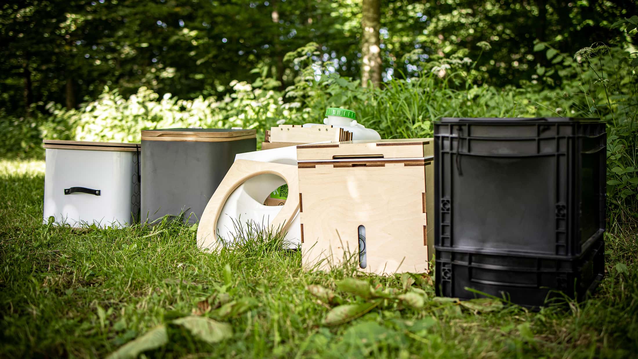

Many campers want a toilet that does not require chemical additives. Separating toilets meet this requirement and can be used in tents as well as in mobile homes.
First of all, a classification of the new separation toilets within the numerous types of camping toilets: The overarching category is called dry toilet . This means that no water is used in this toilet. Bucket toilets are also included in the outdoor area.
The models we tried are camping toilets. The liquids (urine) are separated from the solids (faeces) during the transaction using a separator insert below the seating area. At the front the urine flows into the canister, at the back the solids container waits for the stool.
Separating toilets for camper vans and motorhomes
These chemical-free toilets are suitable for use in camping vehicles. You can read how a separating toilet works here: https://www.promobil.de/zubehoer/trenntoiletten-campingbus-zubehoer/

2. Boxio Toilet
Boxio, separation toilet, plastic, dark gray
The Toilet Up base increases the seat and is another box.
This model is the practical one among the partition toilets: low price, low weight and the seat height can be varied several times. With the idea of producing all products in Eurobox format, the Rostock team has met with open ears from many campers. And yes, there is a bit of an airplane toilet feeling there too. The company processes recycled plastic, manufactures the products in Germany and – like all manufacturers represented here – maintains high social and environmental values.
Additional Euroboxes in different heights can be purchased for the separation toilet. This means that any number of seat heights can be achieved with one toilet. If you have Euroboxes in your storage space anyway, storing them is easy. Boxio even has a mobile washbasin in the same format. Who knows what's to come.
Manufacturer: Boxio
tested model: Toilet
Price: €159.90
Seat height: 26 cm (38 cm with Toilet Up, 50 cm with 2 small Euroboxes)
Dimensions (height x width x depth) : 28 x 30 x 40 cm
Weight: 3.8kg
Capacity: urine canister 5L, solids container 5L
Material: Body: recycled plastic container, polypropylene and polyethylene
Load capacity: 150kg
Spill protection urine canister: With the Safe Shell system, it has a very secure closure even during use.
+Space saving and very compact.
+Eurobox format makes storage easier in many cases.
+Not perceived as a toilet.
+The additional Toilet Up provides extra storage space underneath and offers the possibility of height adjustment.
+Water protection – can also be left outside in the rain.
+Seat with divider can be folded up and remains at the top.
-The lid is loose and cannot be closed tightly.
-No holder on the lid, folds down at the back when in use, very loud when closed.
-Corners a bit difficult to clean.
-Urine canister is transparent.
Conclusion: Practical and inexpensive compact toilet

Space problems? Then the Trelino S or M would be a candidate. The Trelino S is designed for compact vans.
The S version has a 3.5 liter urine tank and a 6 liter solids tank. The toilet seat is incorporated and the lid is made of birch wood. It's barely bigger than a beer crate. We only noticed one small downside: the magnets on the wooden lid are so strong that you always have to lift off the entire separating insert. A fan is not included; due to the small size, it is not necessary according to the manufacturer.
The Trelino M is slightly higher and is optionally available with a fan. It is available in a version made of plastic or birch multiplex with coating. The urine tank holds 5 liters, the solids container holds 8 liters in the PE version and 6 liters in the wooden version. The larger L version has a 10 liter urine canister and a 10.6 liter solids container.
The Trelino keeps a low profile in terms of color: the Trelino partition toilets are available in white or anthracite - with HPL finishing also in natural.
Trelino S
The most compact model looks like a cube with a wooden lid. Depending on your wishes, it is available in white or anthracite.
If you don't have much space in your camper, you should take a look at the small Trelino S.
Dimensions (height/depth/width) : 28.5/40/34.5 cm
Weight : 4.38 kg
Load capacity: 150 kg
Price: 419 euros
Trelino M
The medium Trelino M with all parts.
Dimensions (height/depth/width): 35/39/32.8 5 cm
Weight: 6.1 kg
Price: from 549 euros
Trelino L
The largest version is called Trelino L and the wooden version shown costs 799 euros.
Dimensions (height/depth/width) : 46.8/38.6/31.6 cm
Weight: 8.2 kg
Price: from 699 euros, in wood from 799 euros
Trelino Evo M
M denotes the medium size of the Trelino Evo series.
The quality and sophistication of this new product range not only demonstrate practical experience, but also the high level of development expertise of the Düsseldorf Trelino team. Carrying handles are integrated into the Evo M, and blue canisters make disposal more convenient, even in daylight. Many other features show how well thought out the conception of the Evo product range was. For example, when the canisters are removed, the separating insert remains on its own stand on top; so nothing drips next to it. The lid of the urine canister has an odor and spill stopper made of a high-quality silicone membrane. On the toilet itself, the lid has an automatic soft-close mechanism, rare on camping toilets; Little fingers don't accidentally get caught, and there are no bangs at night that can wake up the neighbors in the tent. The entire system can be used as a seat and storage option.
Manufacturer: Trelino
tested model: Evo M
Price: €399
Seat height: 35cm
Dimensions (height x width x depth): 36 x 33 x 39 cm
Weight: 4.5kg
Capacity: urine canister 5L, solids container 8L
Material: Body: recyclable plastic (acrylonitrile-butane-styrene), container: recyclable polyethylene (planning: switching to recycled material)
Spill protection urine canister: Lid with simple odor and spill lock made of silicone membrane
+Low weight and compact dimensions.
+Ergonomic seat element for very high comfort.
+Lid with soft-close automatic and secure fixation on the separating insert.
+Smooth, water-resistant material with high-quality workmanship without edges or cracks.
+Can be used very well as a stool.
+Internal system for containers with additional lid; no rattling and more hygiene.
+Carrying handles built into the body for easier transport
-Despite good ventilation and cleaning options, the solids container quickly absorbs odors.
-Separation between solids and urine canisters may be noticeable when sitting.
-Soft close automatic must first prove itself in long-term tests.
Conclusion : Plastic toilet that appears sophisticated down to the last detail
Anyone who appreciates clever design and high-quality workmanship as well as comfortable use will probably choose the Timber series from Trelino. Real wood gives the special touch, and the Düsseldorf manufacturer also uses resource-saving materials for the plastics that are processed in Germany.
The downside of the high quality and stability is the also quite high weight of 10 kilograms. When it comes to transport, “Function follows form” and carrying handles are not provided. A fan can be installed for an additional charge. Apart from that, the most expensive Trelino series scores not least with its extremely comfortable seating experience.
tested model: Timber M
Price: €599
Seat height: 35cm
Dimensions (height x width x depth): 39 x 31 x 37 cm
Weight: 10kg
Capacity: urine canister 5L, solids container 6L
Material: Body: birch multiplex with HPL coating, container: recyclable polyethylene
+Stable and high-quality design with an elegant design.
+Comfortable and ergonomic seat.
+Leak protection on the urine canister.
+Very attractive workmanship of the lid holder with stainless steel hinges.
+Available in three colors to match the surroundings.
-Very high purchase price.
-The lid folds back, if necessary onto the floor.
-Loud noise when closing the lid.
-Interior floor made of untreated wood, problematic to clean.
-No handle or indentation for transport.
Conclusion : Particularly elegant and high-quality design for high demands.
10. Trennto
A toilet almost like at home is the separator. The toilet bowl is a standard seat with a soft-close mechanism. The designer toilet is made by a carpenter, which is why delivery times may take longer.
It is also clear that the Separation is a camping toilet.
With its dimensions, the separator fits into most motorhomes. Since the toilet is made of veneered MFD panels (wood), it is not recommended to use it in a wet room. The removable solids bucket holds 10.5 liters, the urine canister is designed for 10 liters. Up to 30 sessions should fit into the solid container.
There is an optional fan set. Before purchasing, you can decide whether the fan should be installed on the left or right side of the toilet.
Dimensions (height/depth/width) : 45/46/36 centimeters
Weight : approx. 13 kilograms
Load capacity : min. 120 kg
Price: 1,399 euros
PART 3: final part
11. Trobolo
The alder wood toilets from Hanover are in a class of their own both visually and tactilely. There are different models for campervans and tiny houses, optionally with a fan and exhaust.
Trobolo only uses wood from sustainable forestry. The separation toilet itself is manufactured locally by a craftsman.
The seat is loosely placed and can be removed for cleaning. Only: If you open the body to empty it, it falls down.
Trobolo Indi-Bloem
weighs 9.5 kg.
Dimensions : 31 x 46.5 x 47.50 cm
Volume of urine tank : 10 L
Volume of solids tank : 11 L
Agitator/fan : no/no
Material : Alder multiplex
Weight : 9.5 kg
Load capacity : 150 kg
Price : 689 euros
Trobolo Tera-Bloem
The simplest version of Trobolo is called Tera-Bloem and costs 429 euros.
Dimensions : 33 x 47 x 50 cm
Weight : 12.7 kg
Load capacity : 200 kg
Price : 419 euros
Trobolo Luwe-Bloem
available for 679 euros. The manufacturer recommends them for tiny houses or gardens, as well as indoors.
Dimensions : 40 x 60 x 50 cm
Volume of solids tank : 22 L
Agitator/fan : no/optional (Leli-Bloem)
Weight : 22 kg
Load capacity : 220 kg
Price : 549 euros
Trobolo Luwe- Buy Bloem in the partner shop
Trobolo Bila-Bloem
Trobolo's most expensive toilet is called Bila-Bloem. The urine is drained away; a connection to the vehicle tank is also possible.
Dimensions : 31 x 43.5 x 47.50 cm
Volume urine tank : drainage. Connection to vehicle tank also possible
Agitator/fan : no/yes
Material : alder multiplex
Weight : 10 kg
Load capacity : 180 kg
Price : 929 euros Buy
Trobolo Wanda Go
Thanks to a simple height adjustment using a reversible foot element, the Wanda Go is super comfortable; the higher of the two levels corresponds to the seat height of a standard toilet. This shows that the company from Hanover is not only looking for people who love to travel as a target group. Various areas of application from tiny houses to self-sufficient gardens are possible. Quality and comfort are based on domestic standards. In the plastic version tested, this toilet is still very light.
When transported, the Wanda Go is flat enough for toilet compartments in camper vans.
If you have a fixed location for your quiet place and for whom weight is not an issue, you can also use a heavier wooden model. The plastic design makes a very robust impression and won't suffer if Wanda Go is forgotten outside in the rain. Not using wood also makes quick, complete cleaning easier. With a system called Safe-Shell, Trobolo has also developed a spill and odor stop for the canister lid, which does not require early emptying on hot summer days.
Manufacturer: Trobolo
tested model: Wanda Go
Price: €249
Seat height: 30cm/49cm
Dimensions (height x width x depth): 31 x 34 x 38cm
Weight: 4.7kg
Capacity: urine canister 4.6 L, solids container 6.5 L
Material: polypropylene
Spill protection urine canister: With the Safe Shell system, very secure closure, even during use
+Comfortable seat height thanks to the reversible base.
+Additional storage space through substructure.
+Paper container for attaching the roll to the side.
+Urine canister with a special lid to prevent sloshing and odors.
+The toilet lid stays up and doesn't close on its own.
+Small seat opening is particularly suitable for children and smaller people.
-Solids container has no handle.
-Handle of the urine canister is very easy to handle.
-The toilet lid has to be pressed into place with a lot of force, which is comparatively loud.
-Edge in the separating bowl without rounding increases cleaning effort.
-Paper container requires a special toilet roll format.
Conclusion : A comfortable model for users sensitive to odors
6 questions about our separating toilet test
1: Do I need any accessories for a separating toilet?
Although no chemicals are necessary, the permanent store is dried out with bedding after use. The most commonly used grit is made from wood, hemp, coconut, miscanthus (elephant grass or miscanthus) and activated carbon. These natural materials absorb odors best in the long term because they absorb moisture excellently. The drier the solids become, the fewer odors they form. Litter recommended by toilet manufacturers is both compostable and highly absorbent.
You probably only transport two toilets at once in a test, but comfort is a criterion.
Many types of grit are mixed with bacterial cultures. These promote the decomposition process of the solids during composting. Practical tip: Don't skimp on the bedding, otherwise unpleasant smells often arise. Other necessary accessories include bags for the solids container. Only those who are not afraid of cleaning can do without bags and inlays. For everyone else, it is recommended to use compostable, tear-resistant bags. There isn't much to consider when it comes to paper. Since the camping separation toilet works without chemicals, no decomposition processes need to be taken into account.
2: What do I have to prepare for if I want to switch from a chemical toilet to a separation toilet?
All of the separating toilets we tried arrived as a package and only needed to be put together. Then all you have to do is place a suitable – and environmentally friendly – bag in the solids container and a handful of wood chips. It seems strange the first time: a dry separation toilet actually doesn't need any water. The handling is very simple. Sit on it and let it flow. In the beginning, some practice is necessary to decide for yourself what the best sitting position is so that the stream of urine is aimed into the funnel at the front of the toilet area.
You may have to move back a little for the fixed deal. If only urine flows into the canister, the toilet lid can be closed again - without any further action. In the big business, a handful of litter is placed in the waste container before and after each bowel movement. It also covers the used toilet paper, because the paper also goes into the solids container. Close the lid and empty the canisters and containers if necessary.
3: Do separate toilets work equally well for women and men?
Now it gets a little detailed. Practice shows that women find it easier to cope with separate toilets. Please note for men: The dry toilet is not for those who pee standing up. Depending on the toilet model, the good piece must be pushed down in the front area. Otherwise it will rest depending on the size and depth of the urine bowl. That's absolutely fine, just not pleasant for every man. For larger statures, the business in the back area sometimes comes to an end because the seat openings are smaller than in conventional toilets. There is often a conflict when choosing the right model for families: large, wide seat opening for men, smaller ones for kids.
4: What do I have to pay attention to when emptying and cleaning?
Disposal of a separating toilet is very easy. In most models tested, the toilet insert can be quickly removed by simply opening the seat or using a lever mechanism. The two containers for urine and feces are located under the seat. The bag with the solids and toilet paper can either be thrown into the compost or tightly sealed and thrown into the household waste (like diapers). Remove the urine canister from the system and dispose of it using a toilet with a water connection.
Everything is completely natural: Many campers want a toilet that does not contain any chemical additives.
If there is no additive in the canister, the urine can be diluted with water in a mixing ratio of 1:10 and used as fertilizer in the garden. Each family has to find out the frequency of emptying for themselves. That depends on the use. Depending on the size of the container, the urine level in the canister should be checked regularly. As with any toilet, all parts must be cleaned regularly. There are various measures and means for this. Almost every manufacturing company offers suitable biological cleaners for their separate toilet systems.
5: What is particularly important when choosing the right model?
The price differences are large: camping toilets are available for self-assembly starting at around 120 euros. On the other hand, you also get very high-quality versions with appropriate materials. Here you have to expect prices over 500 euros. The means of transport also determines the weight and volume of the separation toilet. Are you going on vacation in a small car, van or motorhome? The question also arises: How long do you want and can you travel without having to empty your body? Depending on the answer, the containers for urine and feces must have the necessary capacity.
Important for handling: Is the model height-adjustable so that children also have a good toilet experience? A wide edge is beneficial for children so that they can hold on. How comfortable is it to sit on the toilet seat? Is the lid removable? Does it bang on the toilet seat when you close it, and does it stop on its own when you open it? How easily does it fit into the seating area and how well is it sealed? Can the toilet with the lid system also be used as a stool in the tent? Depending on the location, the question arises as to whether the quiet place is presentable. Further criteria for handling: How tight are urine canisters and solids containers?
Can liquid leak during transport? Are there sturdy handles or handles so that I can carry the toilet easily? Is the opening for emptying the container easy to use and can it be removed without putting the separator insert somewhere? Are there edges and cracks that are difficult to reach for cleaning? Another piece of information for women: white separating inserts are often used. If "woman" wants to avoid a monthly mess, she should prefer the gray version.
6: How did the practical test go and what were the experiences like?
The test subjects were women, men, teenagers and several smaller children from the tent children community who did the most test business between May 2022 and April 2023. There was also a trial run of the test models at the community meeting. No model failed the test. All models shown are stable and secure. In addition, every toilet has its strengths and weaknesses. The concept of the separating toilet was absolutely convincing. The hygienic process without chemical additives also helps to travel the world a little more sustainably.
Every new thing takes some time to get used to. The same goes for the dividing toilet. However, emptying is quick and is less complicated than expected for all models. Cleaning the dry toilets themselves is also hygienic and easy. Even the wooden partition toilets are very easy to clean. You no longer have to rely on special emptying stations during your trip. A simple household waste or compost and a connected toilet are enough for environmentally friendly disposal.
Conclusion
Depending on the space in your, you can now find a suitable separation toilet, even for compact campervans. Even campers with more extensive equipment requirements, such as strong ventilation, can now find the right product. Some separation toilets can even be permanently installed in large motorhomes and connected to a large tank. The environment will thank you and the search for a disposal station will be a thing of the past.
