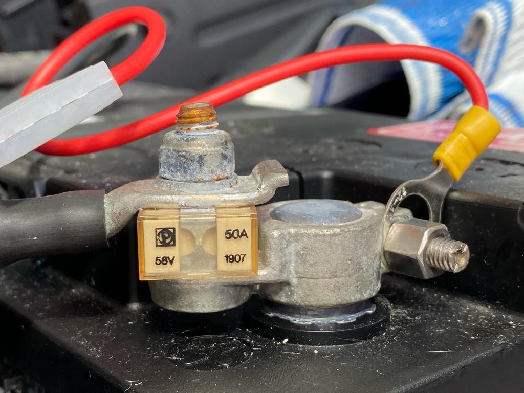

Are you absolutely sure the van system is working correctly?
Are you seeing a voltage rise on the Control Panel when the solar panel is in sunlight?
If not, check the 50 or 75 amp cube fuse on the rear leisure battery +tve pole. You might be running on just 1 leisure battery.

What voltage do you see on the VW California Control Panel in daylight? It should be greater than 13v if nothing connected and Solar Panel in sunlight.
Remove the flap at the bottom of the wardrobe and remove the battery.
Disconnect the red lead and red lead from Solar Panel Controller and wrap them in something. It must not touch anything as it is live, connected to battery under front passenger seat.
Under the red lead is the Cube Fuse. Either check the fuse or measure the voltage of the battery with the cube fuse in place. If 0 volts remove the Cube Fuse and measure battery voltage again.

View attachment 77042 View attachment 77043View attachment 77044
That looks good. Panel definitely working, but do check the Cube Fuse to ensure both batteries are in circuit.
Finally the weekend! I pulled the battery out of the rear compartment and it looks like the 50 amp fuse is ok.
I guess this means that power must be flowing to the other battery. I suppose there is some way to disconnect them and test the front battery under the seat with a multimeter. I might leave it for now I’ll probably blow the fuse if I disconnect it in the wrong order or something!
Thanks for the help again!
