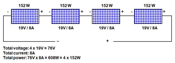

It is possible.
More information here:-

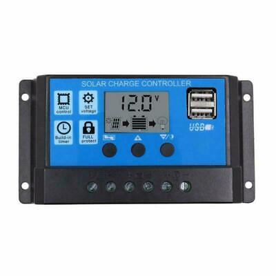

A reasonable pwm controller is about 20 quid.

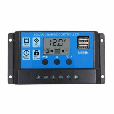

Aye - I replied to your email just now. Easiest way is a £15 PWM controller and connect it to your rear battery. Something like this:
You could of course buy another MPPT controller but as they track battery voltage and adjust accordingly, you might be better off with a "dumb" PWM controller as it'll just shove in what the battery can take, and your MPPT will run along side it.
