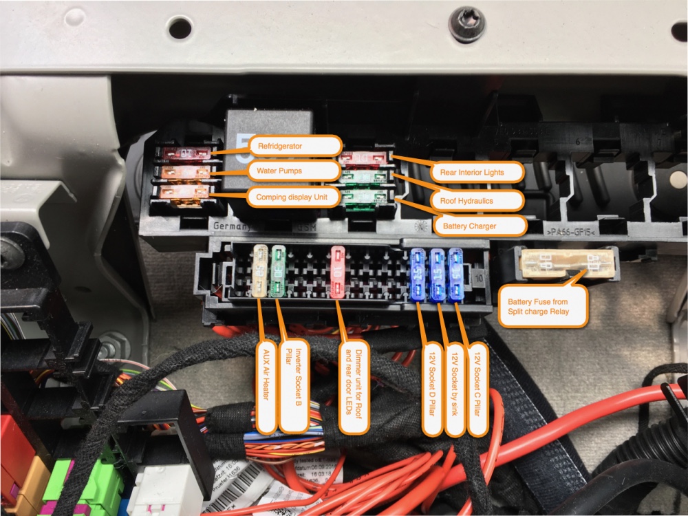

I thought that if i pulled the fuse for the control panel it might reset it, as the problem started after the battery went flat
however the supplement hand book says the panel is fuse 21 under the passenger seat, however there is no fuse 21 that space is empty !
does anyone know which fuse feeds the control panel on a 2017 T6 Ocean ?
i finally got a chance to take another look at this
I’m presuming it’s the one on here that says camping display unit
Under the seat.
Hi might be worth hard resetting the unit if you are happy to remove it then disconnect all the wiring conectors 3 of them leave unit disconnected for 10 mins then reconnect them in size order small to large.
Hello,I,need,some urgent Help! I’ve got a VW California 2014 DSG 4bmotion similarbto,Welsh has..... all my habotaion lightsnfailed this evening plus the overhead light I’ve done onlyn30000 miles so,it shouldn’t be a fuse
The 12v cigarette socket works by the bench seat as,does ON EHU the 12v socket on the side of the kitchen unit as does the UK 3 pin plus on the side of the kitvhen unit so,which fish and where do,I need to investigate?/
80amp fuse Under the passenger seat. The fuse unit is at the front of the seat the fuse is towards the back of the carrier
ok so i pulled the fuse for the control panel and left it out for 10 mins
then put it back and hey presto fresh water gauge is now working !
but waste water only works if you fill the waste tank to the top !
the half full level is not displaying
strange that all was fine before the battery went flat
