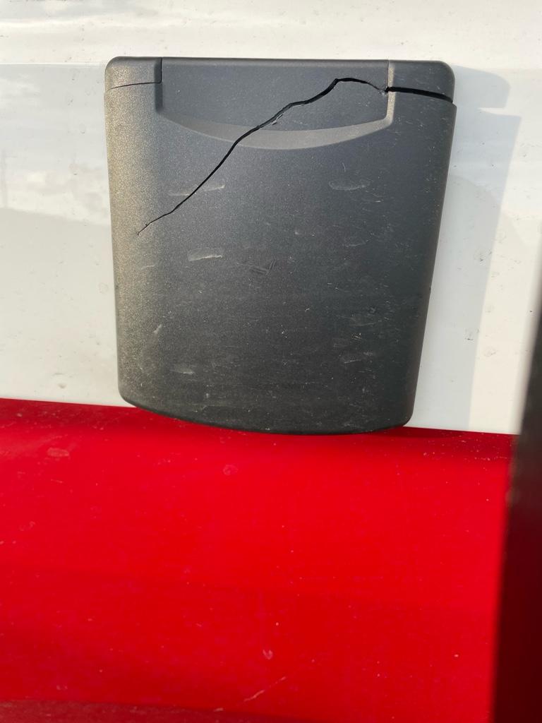

Does anybody know where to get a replacement flap for the water filler?In my opinion it’s a bad design- I opened the door after leaving it up and the sliding door broke it!
Good evening I think quite a few of us have done the same.
Google Fawo Fresh Water Inlet Filler With Magnetic Flap approx £23 compared to VW £50. It’s literally a 2min job to change. Slightly loosen all four screws and the lid part slides out, slide in new one and retighten screws.
Superb!
I seen this when searching but didn’t know whether it would fit or not.
Many thanks
