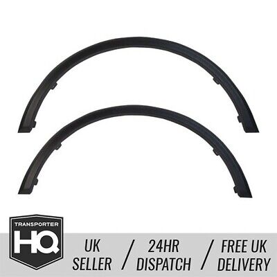

You can get after market ones that cover the whole wheel arch, but I preferred the MAN/VW ones being a little more suttle, well that what I thought! transporter HQ have a “how to” video on YouTube :thumb
Yes, like these: (pic stolen from the UK GC Facebook group)
