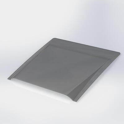

I have one of these fitted. I got the first "test" one from the company who make them. I have had it on for a year now, no leaks even with window open all day on campsite.
Although a decent workaround thats not something I would be happy with.
I'd rather but the £££ towards an aftermarket window - just need to find out if it would work with the Beach plastic trim.
