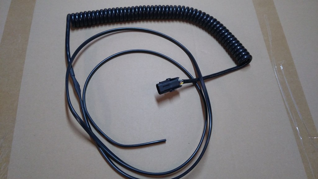

I've made my first curly cord upgrade - it is great quality. UV resistant, and tollerates -30c to +90c before the curlyness is effected. Thick cores too, which are above spec for the solar current of 2 panels.
This will be available as an upgrade when ordering, and also as an aftermarket upgrade, once tested for fit on a very helpful existing customer , hopefully next week.
Hi Roger,
Would you be willing to supply just the curly cord for DIYers? I'd like to replace our wiring with something like this.
It'll only be as an upgrade to existing customers, or with new kits, sorry.
You can get the cord on ebay without the connector and extenstion.

Count me in for a curly cord upgrade Roger
No probs Taff. I'll post back here when I've done testing - which could well be... tomorrow!
