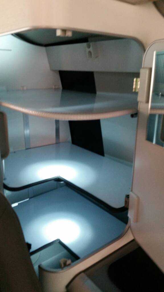

Seeking for Room for our upcoming Scotland Trip
So, here are some of my mods
Rack over Kitchen
Speakers out of Roof Box and two deperatirs out of Dibond installed
Little extra storage on the Seats
Dibond Boards installed in the middle Cabinet
And some white Carwrap Folia to protect the Glass

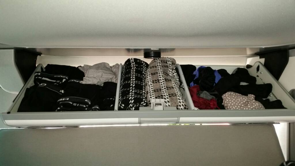

Hi,
As I was reorganizing our Cali today for the 8th time in eight years, I realized how many small adjustments the bus has gathered in time - call it minor repairs. Improvements in creating extra room in our little fourwheeled hotel room are by definition always minor.
I thought, maybe it's useful to show some of them.
Here's a first one: our two stores deep kitchen drawer. To be honest, I nicked the idea from a Spanish Cali-owner, who build it with wood.
My construction is simple: two crossed aluminum bars, 1.5 mm thick, 1 cm high, both cut about 4 mm in the middle.
Don't forget what you through in there. First trip we used this, I angered mss marchugo by asking her where she had left the scissors. Of course I stored them in this drawer myself.
Regards from Amsterdam,

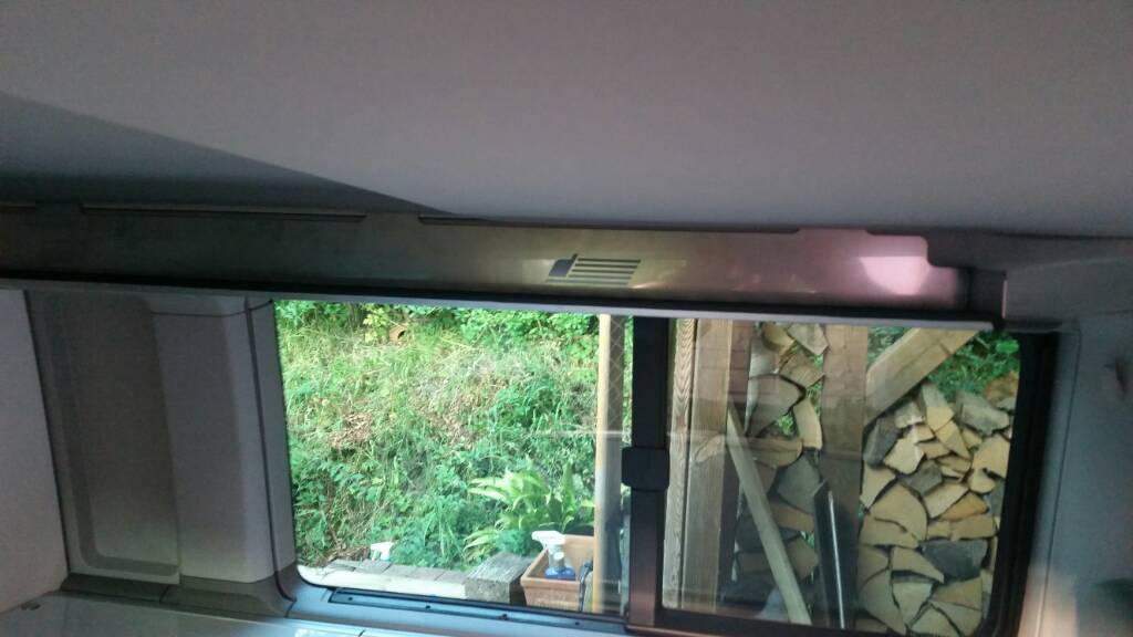

Heater sensor finally listening to our body, in stead of to it's own airflow
As we were unsatisfied with the performance of the Cali parking heater (cycling from too cold to too warm), we had the temperature sensor moved from below in the heater duct, to the inside of the van, to the C-pillar, at the height of our heads when sitting in the cabin.
It's the small black plastic rectangle above the handle next to the sliding door. An extra cable runs unvisible through the pillar, to the controller of the heater under the van.
It improved a lot for us, now that the heater is adapting to our feelings, in stead of reacting to the air temperature in the suction channel below the floor.
Marc.

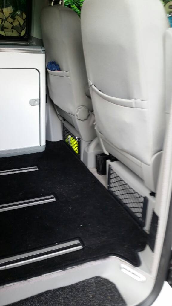

The two black netting pockets at the rear of the front seats are they VW parts or from another supplier?They look so neat and would like to buy a pair.
@Cali197: These are not pictures of our Cali, but this kind of pockets are for sale all over the net, Amazon, Ali, Ebay, for a handfull of euros/pounds.
I have made a more simple version myself:
Just a pair of elastic cords with knots at the backside of the panel.
Marc.
