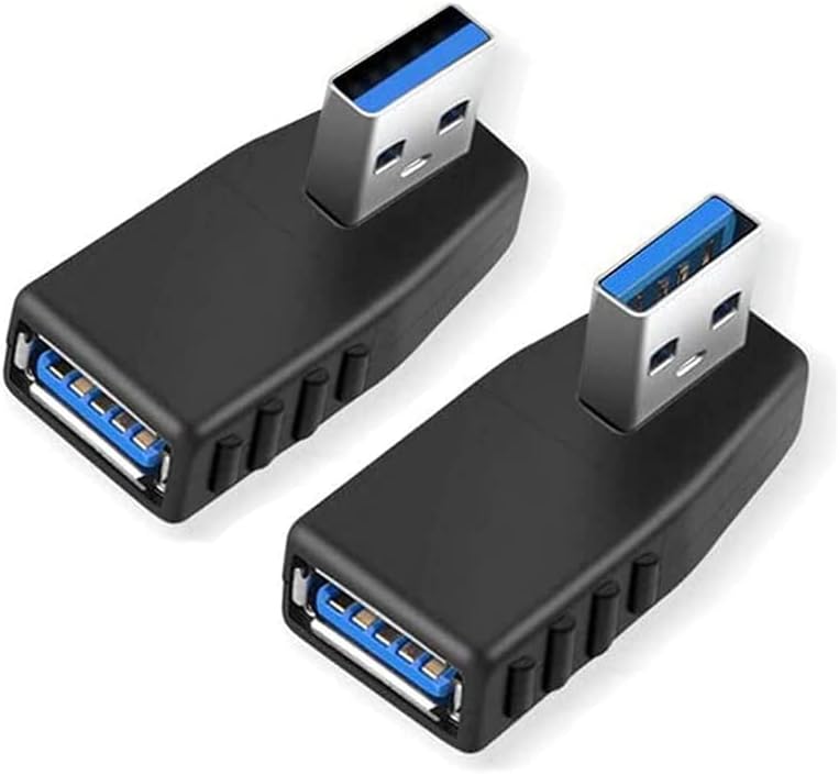

just ordered a 90 degree usb adaptor so to stop it being snagged and neaten things up..

Bought a low profile usb socket with a 90o adaptor to minimise protrusion into boot.
