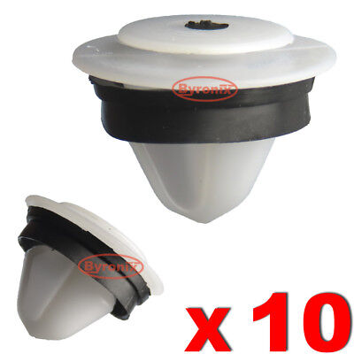

There were a few difference, my 2010 California has small retaining clips to hold the wire ends into the door guide roller which prevents them coming out, the spring was on the outside not inside and I used a loop of thin nylon string to pull on the spring to pretension it. I also found it difficult refitting the panel with black clips like the original and so purchased some white ones that made it really easy, links below. I only had very slight noise as the cables and reels rewound initially but all quiet after about 10 opening and closing of the sliding door. The most important part is getting the pretension correct, I cut my cables 15mm shorter than the marked end position on each reel, see above video. I'd read various comments about issues crimping the ferrules so I purchased an hydraulic crimper that made it easy. Complete repair cost £12 plus £26 for the crimper so slightly cheaper than the VW quotes of £561.80+Vat to supply and fit :)

White Panel clips X10 £4.85 ...
