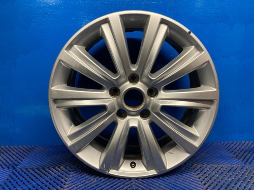

7.5" x 18" Alloys also fit such as this one
