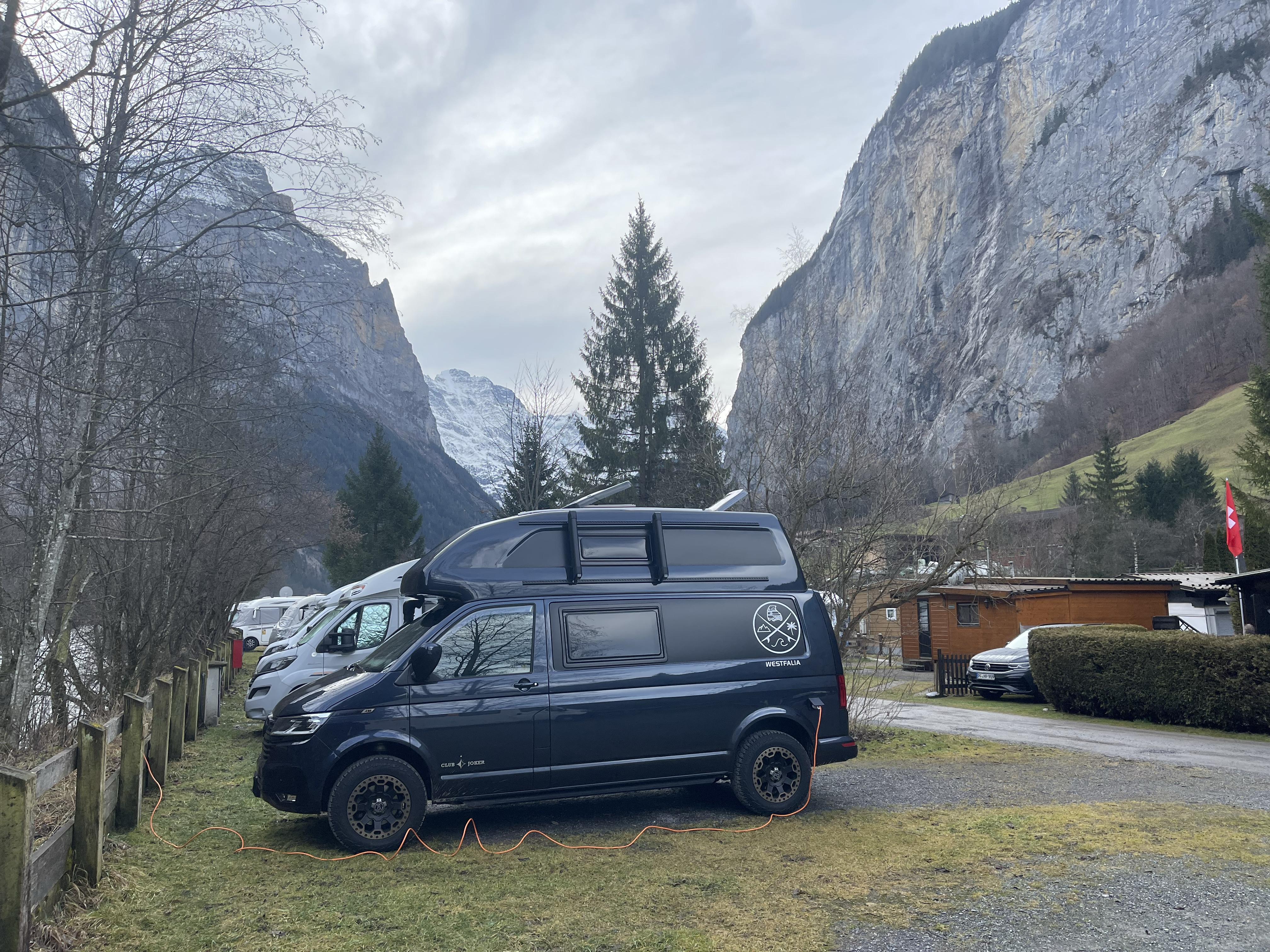

I have a VW T6 Westfalia Kepler One and I love it.
Although there is one annoying aspect: I can't install a roof rack since it has no rails. Apparently the roof is a completely different construction than a regular T6 Cali.
And I do want to travel with my surfboard(s). Now I can put them inside the van easily for day trips, but not handy during the night off course since the space inside is already limited.
Now I've got a particular idea to put the boards on the side of the van. Such as the image I'll attach in this post.
Do you guys think it's a doable option?
I would like to attach something to the rail of the awning and a second attachment point lower on the car itself (maybe with a sucking pad such as the seasucker solution).
Between the two attachment points I'll have to create some sort of aluminium frame or bar to attach my surfboard.

Thanks for yr reply.
Nah, not really short boards. They are 7.6 and 8'.. so the longest is 244 cm.
I've got the thule Backpac 2 attached to the Tailgate.
I'll search the forum to check out their solution. Or do you have a direct link/photo?
Maybe it can be a workaround to out the boards inside and place them on the tailgate like you've mentioned during the night.
* to have the boards inside while driving and on the tailgate when standing still/during the night

Thanks for the replies!
I was already looking at the seasucker's solution. Emailed them and they don't cover warranty for vertical attachment:
Our racks are not designed to be mounted in a horizontal side position.
I have seen our racks mounted on the side of our VW bus but it was parked and done as a fun thing.
I am sure customers do it but we do not cover any warranty or damage if it occurs.
Customer Support
On the roof itself it seems like undoable since it requires a metal surface iso "plastic". + it would block the sunlight for the solar panals - when I install them one day :)
But I do think the solution lies in a combination of attaching it to the awning system and a suction cup.
Tailgate looks nice as well, but undoable with the longer boards I own.
I'll keep on investigating

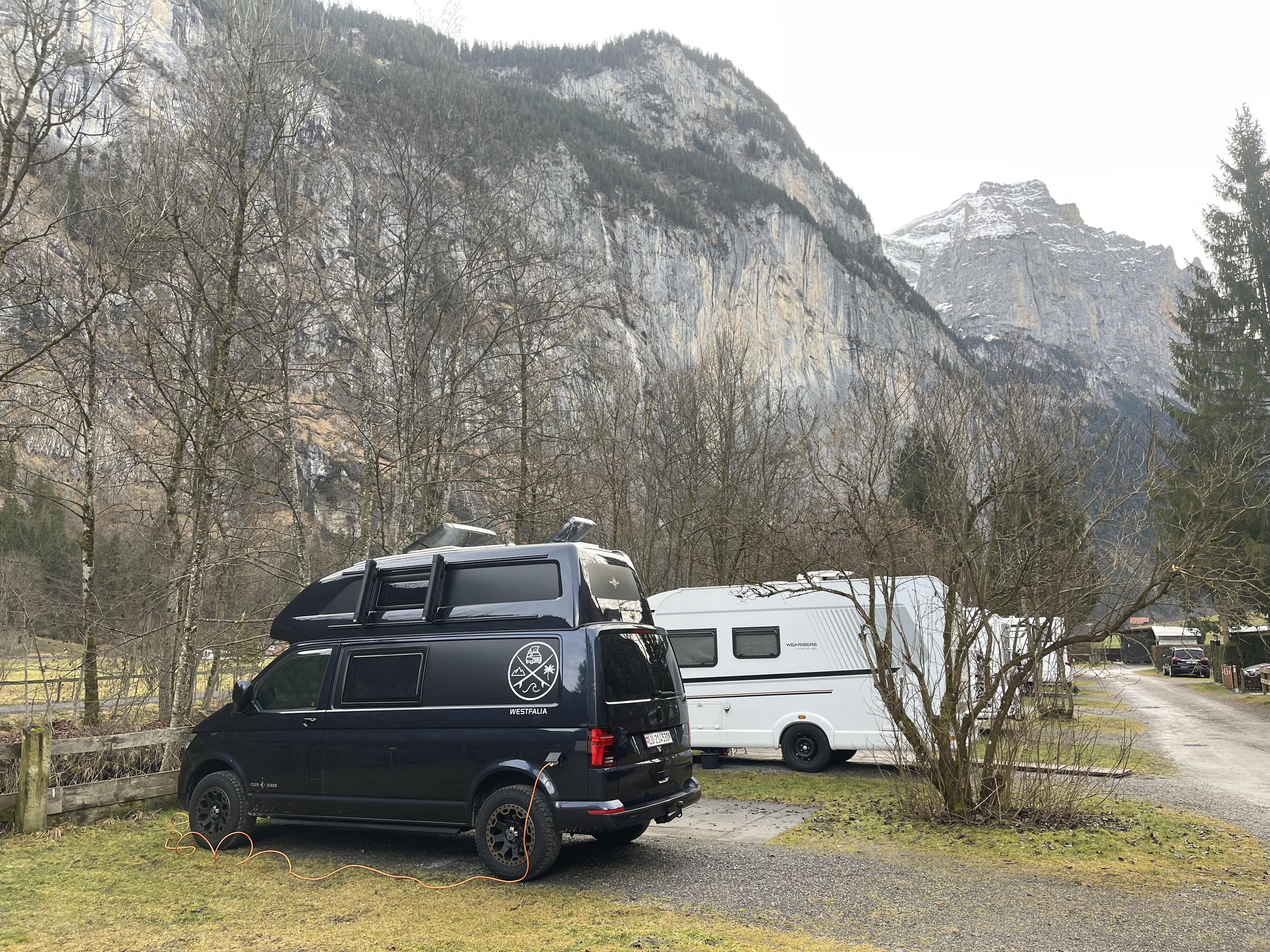

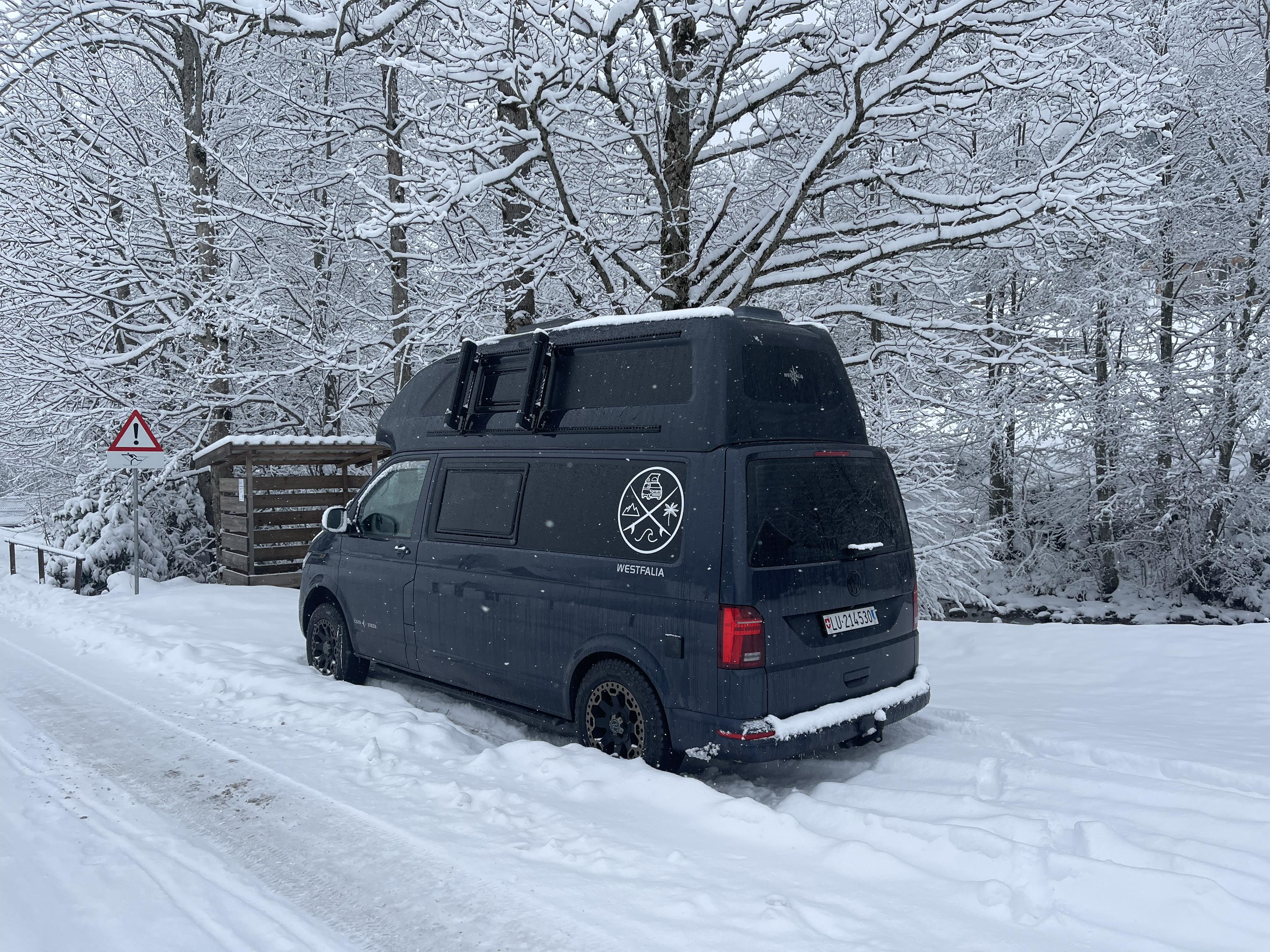

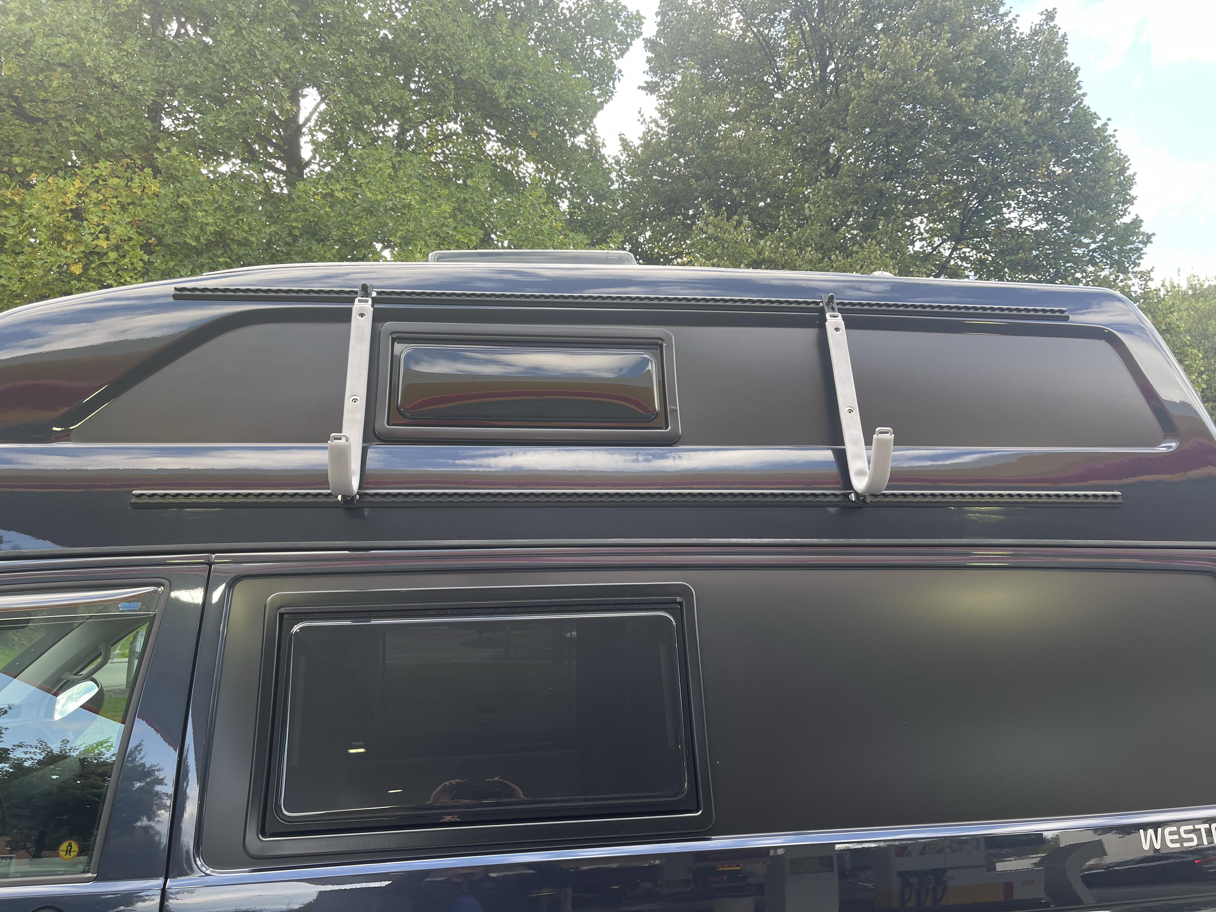

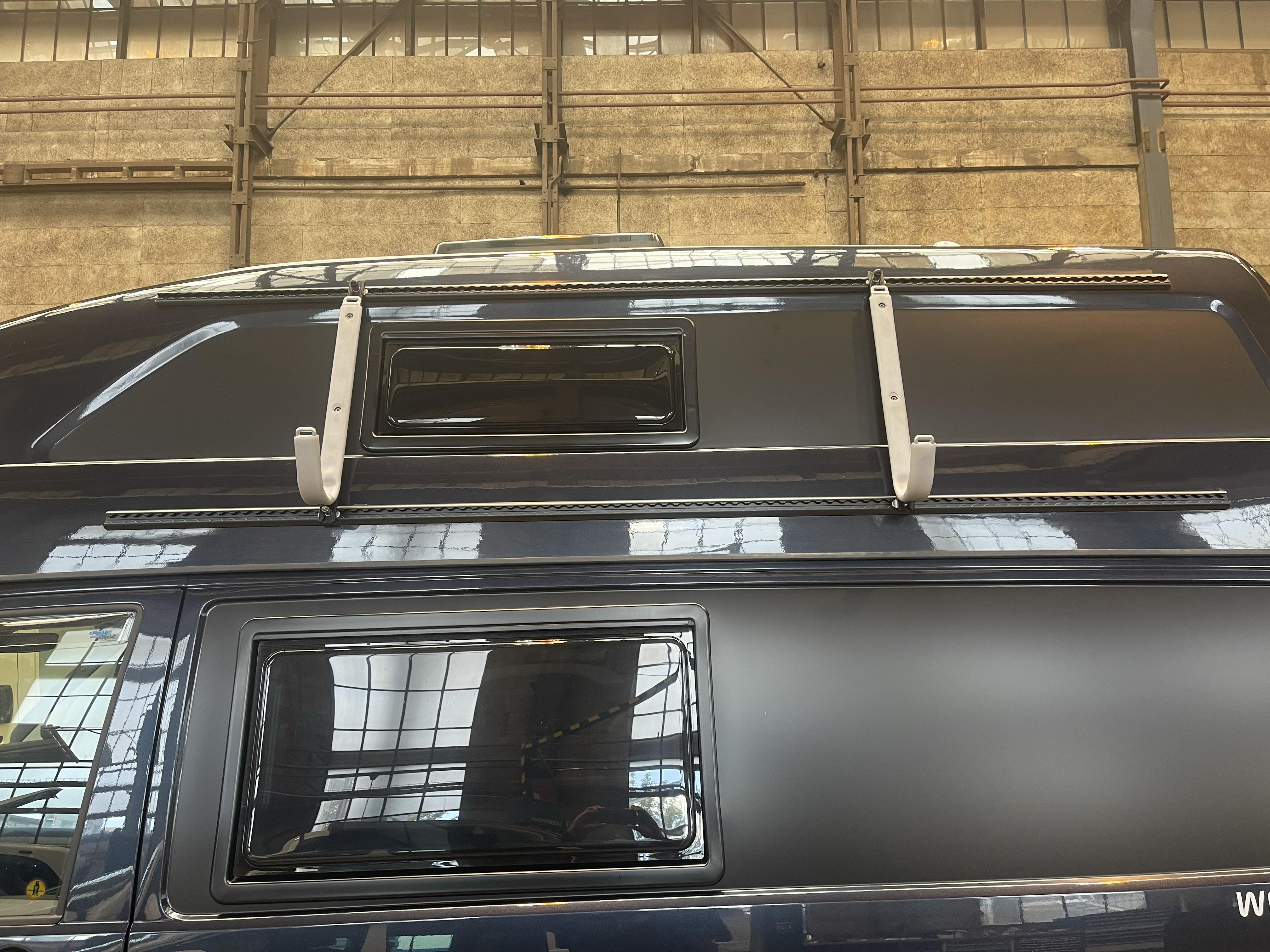

Here are some images which show pretty much what I (sort of) want (I especially like the idea of building "hooks" that can be folded inward:
45920
4592145922459234592445925
View attachment 45921View attachment 45922View attachment 45923View attachment 45924View attachment 45925

I installed airline rails on my van and added 2 smaller airlines between them that I can move around. In winter I use Thule snowboard racks and in winter surfboard mounts for surfboards or paddle board. Unfortunately I don’t have photos with a board. Will keep that in mind next time!

Hi there, no drilling required. I just used Sika Flex! Works fine for 2 boards. I mount surfboards and SUP’s in summer and then switch to Snowboard/Ski racks in winter.
