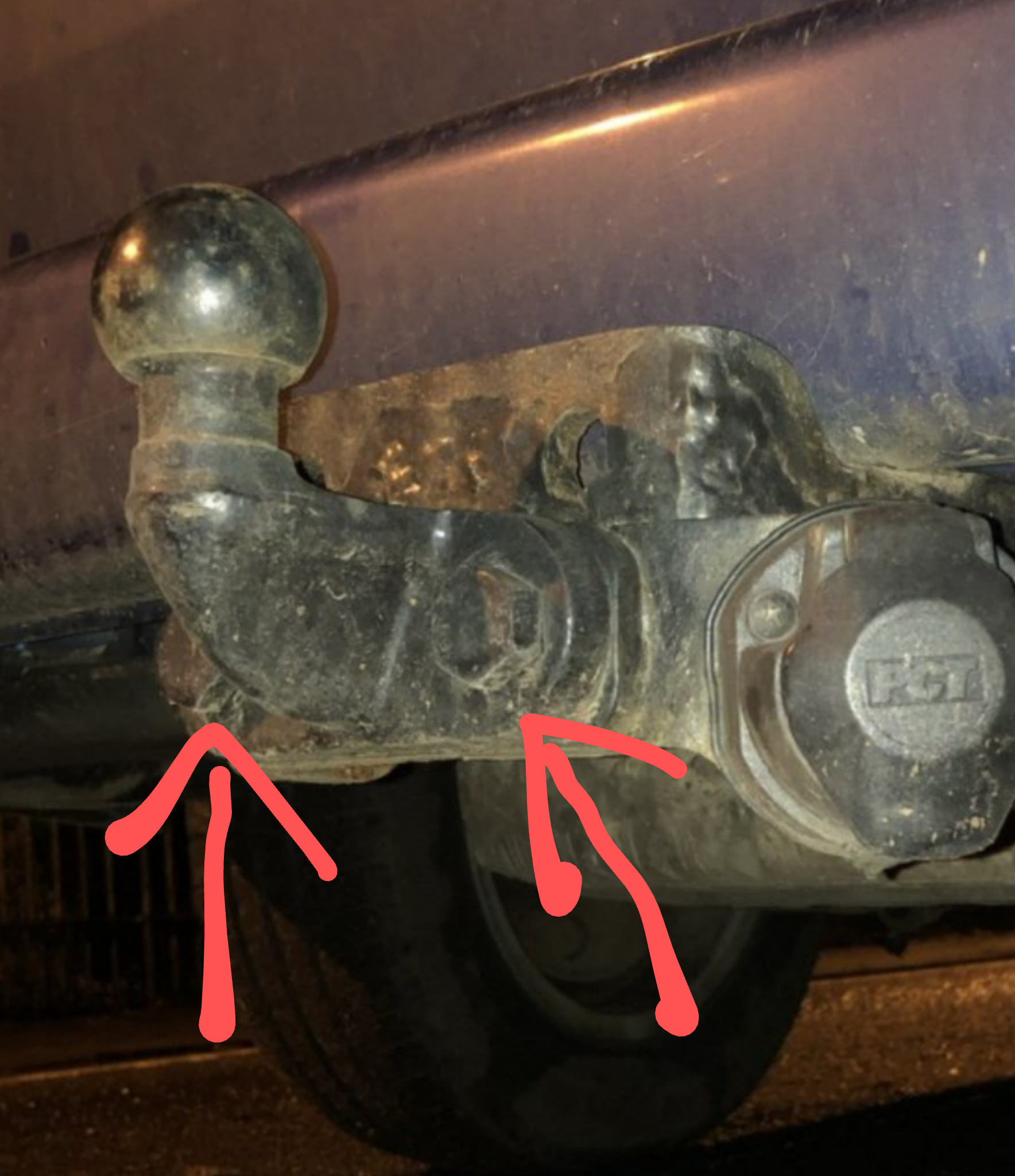

Thanks for all the responses so far folks! :) Here are some pictures...
Just unbolt the Tow Ball. Your Rear Parking Sensors should then work correctly. Otherwise it will be an expensive job to remove everything and replace the Original parts removed to fit the Towbar and probably cost a good few £100’s of pounds.
As far as getting the Parking Sensors to display on your new Head Unit. If properly wired then it should be a simple matter of coding.
Obviously this all depends on the Parking sensors working properly.
Remove the Tow Ball, big spanner, and if the sensors don’t work correctly when reversing then they need fixing first. Once they are confirmed to be working then you can look into checking the head unit is properly wired and getting it coded.
Hi Mike,
Dunno if this helps but... We’ve got a T6 Beach 2017 and had a towbar fitted just after we got it. They removed a metal bumper bar to fit it. It’s just sat in my garage for two years ... tried to sell on eBay but no one wanted it... you can have it for free if you can arrange collection (in north Notts or from north Birmingham) or for postage cost. Dunno if it fits your Cali as well but it might.
Mark
To my uneducated eyes, that tow bar looks as if it was designed for a JCB!
Mike, if you try and remove these two bolts, the tow bar ball should come off. However, as it has been there for long, may not be an easy job. Best to go to a local mechanic, who can help you with it. This by far seems to be the easiest temporary option to save you shins.
If you want it clean looking then get the three webs cut through underneath with a grinder or a plasma / burner. Tuck the wires away. Cheap quick and easy if you have the gear. Will to all intents be like no towbar fitted. Good local garage could do this.

Brilliant advice. Thanks very much. I’ve tried to remove it today but one of the bolts is totally seized up (some rusting) so I’ll need the help of a garage I think. I just can’t shift it. Thanks again.
Soak it in wd40. Get some heat in it and use a good socket and long bar. Also hit it face on with a hammer too to 'wake up' the rust. Should easily crack
