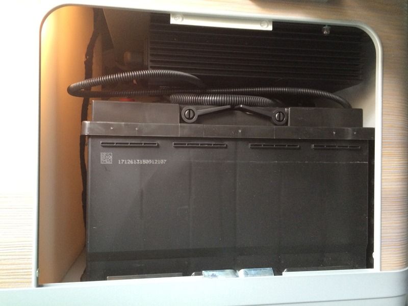

Just been cutting a hole in the removeble panel to acces the rear lesure battery .
Behind and under the wardrobe sits lots of electric parts of your Cali , in hot temperatures it is possible the inverter gets into a fault modus when overheated .
My inverter sits under the fridge , on newer models ( think 2013 and up) inverter sits in that rear leusure battery compartiment .
So placed a venilation opening as extra inflow of cooler air.
Together with the fact i removed the plastic cap in the left front cabinet under the sink/ coocker there's more airflow....you also could remove the cap in bottom of the wardrobe where'r you can hang clotings
Here some pic's step by step and the result....:thumb
Maybe some of you will get inspired!

I know , they sell it at CC in Amersfoort , a ventilator that fits in the hole afther removing the cap under the coocker to ventilate the fridge engine....
My solution is cheaper and don't need any electric connections , it will do the trick for now , i think if one go travelling to say , north Africa , or very hot places a fan is probally a better solution

The batterycompartment in the back is definatly not sealed ....take a close look at the wardrobe fitting , it has all around spaces !
And is your battery under your front leftseat in a seald space....?
Let me know if your Cali has does options , ours does not;)
The battery has a overflow rubber tube that leads gasses outside the verhicle , as long you don't remove that rubber tube you should be fine.
Both of the leisure batteries have small vent pipes that go through a hole in the floor.

I'm not trying to make miracles happend but think for a minute....
All your electrical parts like fridge and inverter are in a closet , between two panels , the inside of the van behind the wardrobe is not insulated so the sun on the metal carbody heats the space up ....this vent creats " some" xtra circulation behind the wardrobe .
When i am on site , there's always some kind of ventilation as in , the roof opend by the zippers , sliding window , air- vent in the boot , airscreen in the front side window,sliding door opend
So ventilation and automatic xtra cooling of the inverter and fridge motor.
Cost me about 4 euro .
Don't think the watertank is gonna cool much , the water will pretty fast warm up!
One can do wathever they want with it , but i think it is a plus .....
Ps , got the tip afther discusing the fact of the inverter going in alarm from overheating, from the biggest and most selling VW camper/california dealer in Holland , they don't talk nonsens;)
Hot air rises and in a California, in the sun, the temperature at the highest point will be greater than at floor level. So having a vent in that inspection panel, and the fact that I do not think the wardrobe unit is air tight above should allow there to be a flow of air upwards IF the temperature around the battery and charger unit ( it is definitely the charger unit in my 2014 California ) is greater than the temperature in the California. What might improve this mod even more is to ensure there is a good passage of air upwards out of that compartment rather than depending on fitting tolerances as a vent. If you get my meaning.:thumb

@Andresz , you got a point but still think that one vent or removing the panel will cool more than the watertank .
Let's just keep it in the middle , i am happy with what i did and by showing it on the forum , might give others the idea to do it also!:thumb

There is definitively space for improvement. I myself had fridge overheat shut down in some occasions on a sunny days. VW made a good step moving the inverter away from the fridge motor, so they do not heat each other. If this step was sufficient I do not know. If the problem still persists I would rather think to install an electric fan, making active air flow cooling.
Seen the fan that fits in the hole in the cupboard , maybe will be installig that aftherwarts , it coast more and uses power from the lesurebats.
And if a fan is installed a xtra vent like i just made is for sure a plus letting air in/ out...!
One remark: I think such a fan should be supplied by a low voltage cut-off circuit. If you supply it directly from the batteries, there is a high risk of flattening and destroying them.
