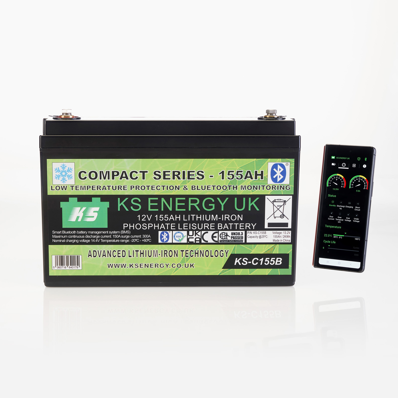

Anyone replaced the under-seat battery with this 150AH KS-Energy Lithium?
A
a892374923874
182
Dorset, UK
T6 Beach 150
This battery on its side almost exactly matches the dimensions of the rubber cover over the Varta LA80 under my 2019 Beach passenger seat.
It is 330 x 170 x 215 LxWxH
LA80 without the cover is 315 x 175 x 190
I already have 200W solar, with a Victron MPPT, and a Victron 30a B2B. Both these have lithium profiles. I'll keep the factory mains charger for now, as it seems like a big job to get to it.
KS-Energy say they fit them quite often in T6s on their side, and the factory mains charger with an AGM profile will be fine - the BMS will stop charging at the correct voltage.
Anyone fitted one, or got any reason not to get one? The 150AH capacity is very attractive.

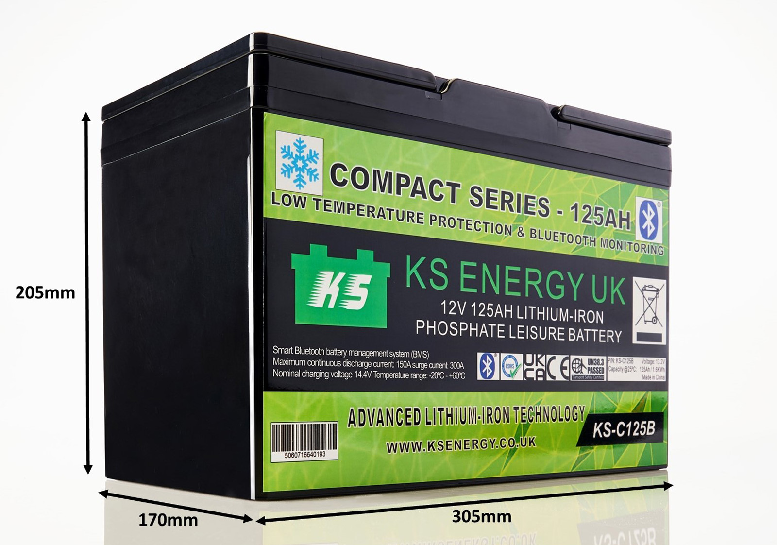

I've taken the passenger seat off and removed the original battery to have a look. Conclusions so far:-
  1. The Roamer seat base battery won't fit under the passenger seat. It is too deep and too wide. Height is ok. It should fit under the driver seat though.
  2. The 150Ah KS Energy battery might fit sideways, but it is too wide and deep for the existing battery tray without mods.
  3. There is a 125Ah version that will fit in the tray as is, but it is 15mm higher than the existing battery. I think this will be ok, but need to do another check against the bottom of the seat at full forward and backwards positions.
  4. The Renogy and TNpower batteries are lower capacity, and too wide and deep to fit in the tray without mods.
Thanks for the pointer to the DIY batteries. Interesting reading. I'll stick with a commercial one this time around.
I'd rather have the battery permanently installed rather than a portable option.
Just a note of caution with point 3. Check that the Airbag cable under the seat doesn’t snag, it can very easily be damaged as it’s quite flimsy.
Good point on the airbag cable.
I think the 125aH battery is the only drop in replacement I've come across.
It is 305 x 170 x 205 LWH and should drop straight into the tray.
There is 30mm above the (190mm) existing battery height before it snags the rear seat bar, so the 205mm battery should be fine and give enough room for the airbag & seat heater cables. The terminals are on top of the 205mm, so I've got 15mm to play with, including some protection.

I ordered the 125Ah battery. It is 5mm taller than the specs which stated 205mm, which means there isn't enough clearance (just) for it to fit on the battery tray in normal orientation.
So, I've installed it on it's side. As it has a wider footprint than the battery tray, I've added a piece of 9mm OSB to the battery tray which brings the base of the battery level up above the lips on the tray.
As an alternative I could get a new battery tray which doesn't have the lips, but no need for now.
