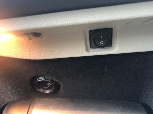

Might help someone. When I had mine put in they put in a switch here. Means I can choose to turn it off easily if I wish, which in my circumstances I normally do. If it’s in a car park I just leave it on and it goes into parked mode.

I also have fitted a power switch as Mike (T6 CFO) has done. I can switch off the cameras when I want, which is usually when we are on a site living in it.
