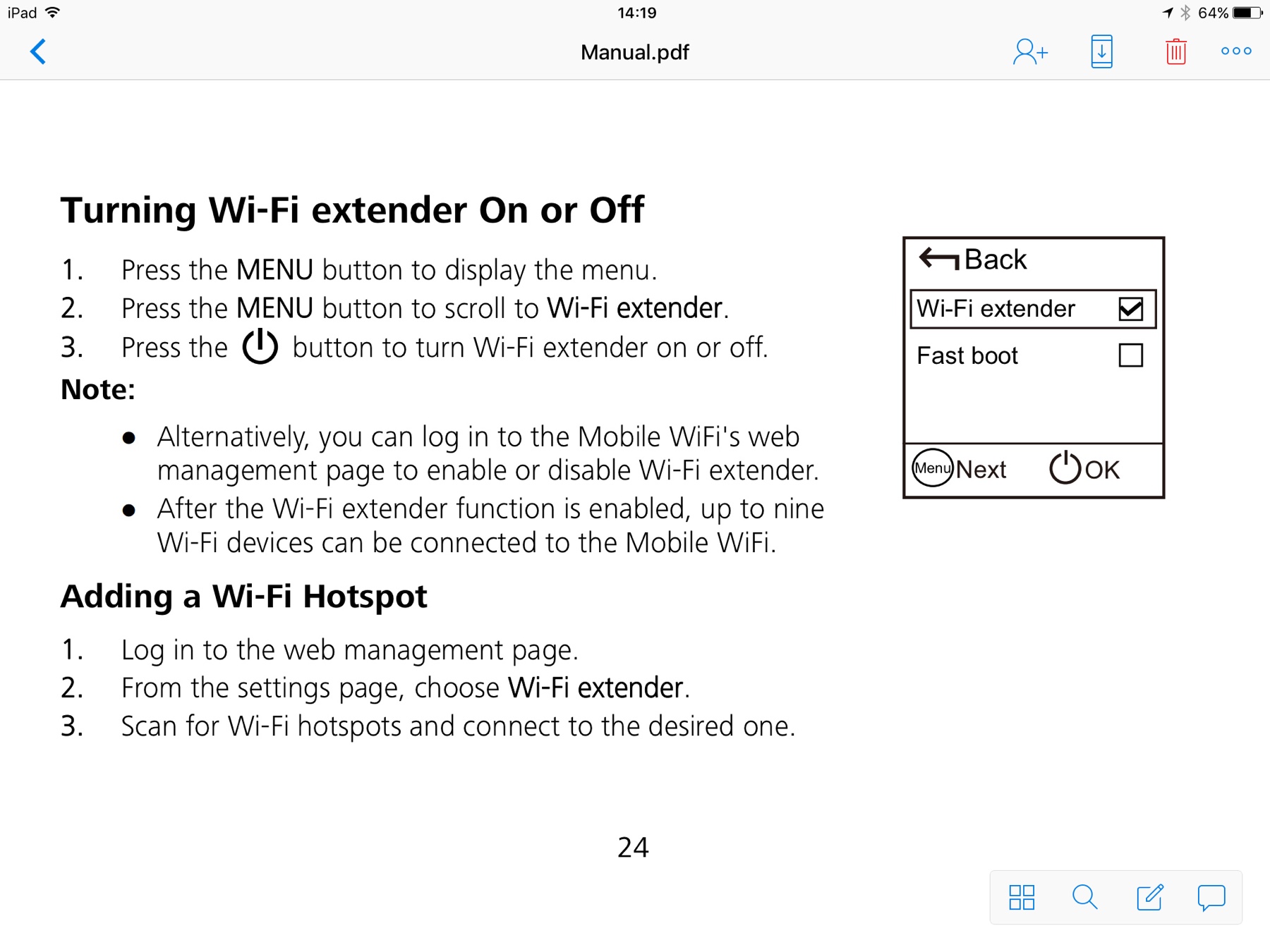

Have you managed to use the mifi wifi extender on campsite wifi systems where they have a login page? If so how because I have tried but failed with my E5377.
Haven't tried yet in the wild but I see no reason why it shouldn't. It logs in fine to the two networks I have tried. I'll keep you posted on campsites.

Just dug out my manual. Does your have this...?

If you download the HUAWEI Hilink app you have the ability to link to free/local WIFI hotspots, which shows access to Internet without using your own data
If you download the HUAWEI Hilink app you have the ability to link to free/local WIFI hotspots, which slows access to Internet without using your own data
Yep that's how I do it with the e5786
Mike
You can scan local wifi and join them, as long as you have password
Yep agreed. Not sure if bigmacs e5377 has that option?
