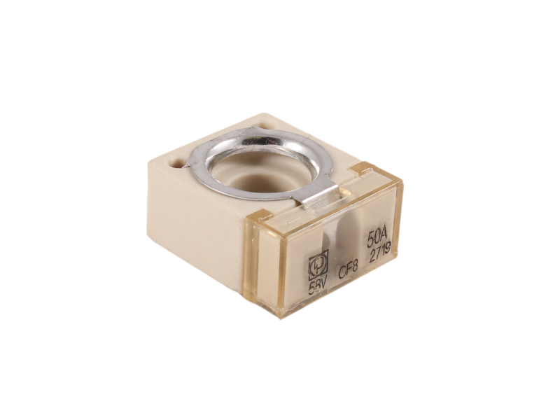

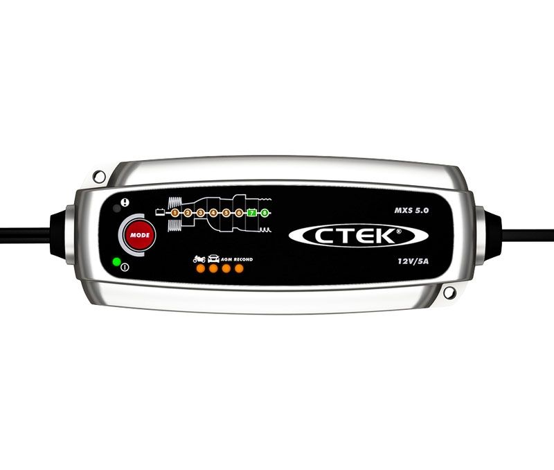

Remove the rear leisure battery.
Recharge it with a battery charger. Once fully charged then replace it , fitting a new 75amp Cube Fuse.
NB, when removing the rear battery, undo the battery clamp bolt. Use a Paint scraper or thick knife blade to ease up the front of the battery over the lip of the battery compartment. The battery leads are long enough to lift the battery into the boot area.
Then disconnect the Black -tve lead and the Red +tve lead and wrap the red lead in a dry cloth or rubber glove. IT is still live as it is connected to the front Leisure battery.
Remove cube fuse, charge battery , new fuse , reconnect battery and replace battery in compartment.
Cube Fuse.
Battery charger if you don’t have one or cannot borrow one.
Cube Fuse.
