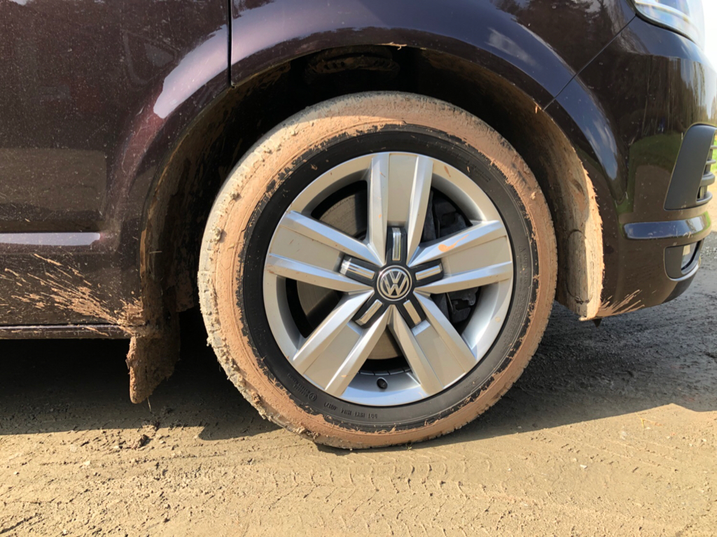

This said by campsite owner in very soggy Ledbury yesterday, whilst sitting on his tractor.
I only just escaped “the Somme” using the Fiamma grips under the wheels (twice).
The tyres on our MY17 Ocean are truly useless on soft ground. The campsite owner insisted that snow and mud tyres made no difference.
Any recommendations?
(I did try to tick the 4M box when ordering, but could quite bring myself to)
Yes that is why I posted thread about ATM Tyres but there just are none available in 255/45 R18!!!!

@Borris- I agree, which is why I didn’t tick the box. Even dragging a heavy boat up slimy slipways is fine most of the time.
I was just wondering how much difference tyres make.
For the record, I got myself out. Tractor man turned up to make sure I didn’t plough his camping field.
The Cali was quite forlorn- DSG, as soon as I put it in gear (foot off gas), one wheel would immediately start a leisurely spin. Any attempt at the gas pedal simply resulted in digging in and muck spraying. The fiamma ladders were really good.

Michelin Cross Climate. Seen a lot of action in mud recently and so far quite undisturbed by the whole thing although I am under no illusions that the depth of mud that there is around may well exceed limits somewhere.

The Michelin Latitude Cross gets great reviews by all who use them. Unfortunately for me, no suitable 18" size available.. so I'm still looking
Or other clever 'extract your self from the mud' techniques assuming there isn't anyone around to pull you out?
If you have a compressor, air down the drive tires. This will often help as long as the vehicle isn't beached, just slipping on slime.
Can also try this or this. I've done that with a table cloth and oddly enough, once tried the same with a tow rope. Both occasions with great success! Not tried the stick, but looks like it works well too.

My Conti Vanco FourSeason 2 are fantastic in mud and also have a snowflake symbol on them.

Never got stuck with my Goodyear Vector 4 Season's in 3 years, always a first time though. ;)
I take a sealed plastic box of road salt with me as insurance. If I have it, I don't ever need it. Doesn't take up much space but gives me reassurance if I do get into a snowy situation.
I have Goodyear Vectors, like @MattBW and others, and haven't got stuck yet, but have had a few close calls with mud in campsites this year already.

If you’re REALLY desperate and there’s no help around, you can use your footwell mats to gain traction.. final option I guess but it works.
Ever looked to try these in the slightly larger 255-55 R18 size (10% extra on the height)?. Few reports on here by others that they fit with no major clearance issues.
