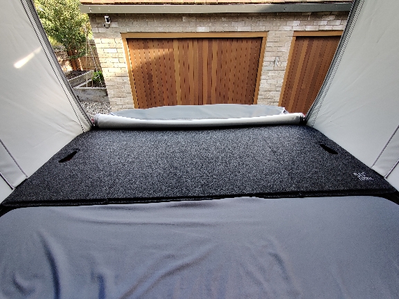

Following on from chat earlier in the thread, for those who were wondering about the CaliBoard & CaliHeat we got from 50Nord, we've just put a new video live detailing the installation and first impressions. I know a number were interested in it, so thought i'd share.

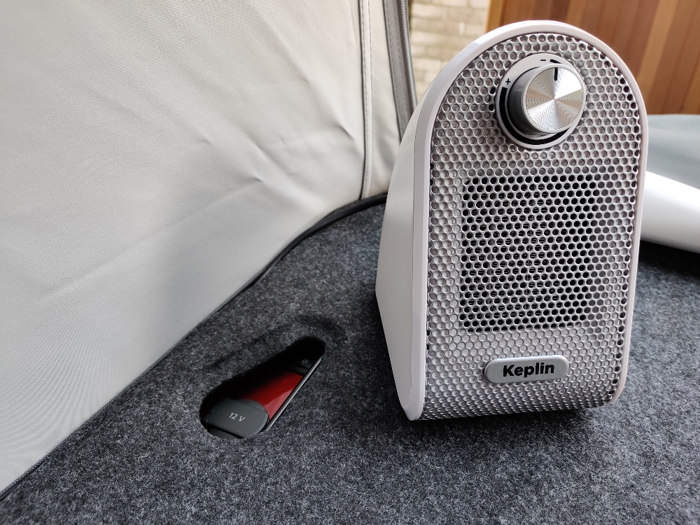

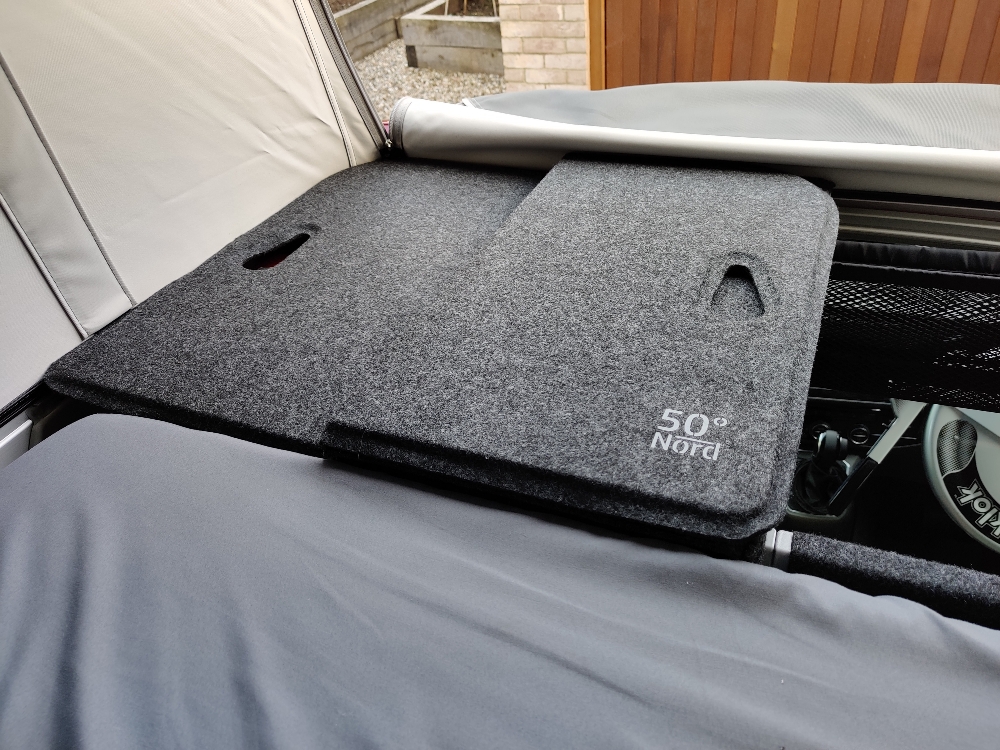

RE the holes in the CaliBoard - either side has small cutouts for the lightswitches and 12v socket. In addition, there's a single circle cut out which the CaliHeat bayonette fixing attaches into. Realistically you only want it on the right side as thats where the airvent is, but I believe 50Nord offer both. But if you wanted an electrical heater instead, i'd suggest finding a 12v heater; it's a small space, and you should be fine using the socket in the roof bed. If not, then yes, you could run one from downstairs up to the top. The CaliBoard sits ontop of two little rubber feet at the top and a metal plinth (drilled into the metal bedframe) covered in felt. The ideal point of entry for a cable would be the 12v socket area, as it doesnt sit perfectly flush (nor need to I might add).
The storage net I refer to is the one which comes with the second small draw option, not the "pillow/child catcher" that comes as standard. It is permanently installed on a couple of rails on the metal area (with the light switches) either side of the opening above the front seats.

The alternate you suggest of a 12V heater is a good one, although the ones I've found all look pretty feeble and low quality compared to a 240V 500W desk heater that I was thinking of using.

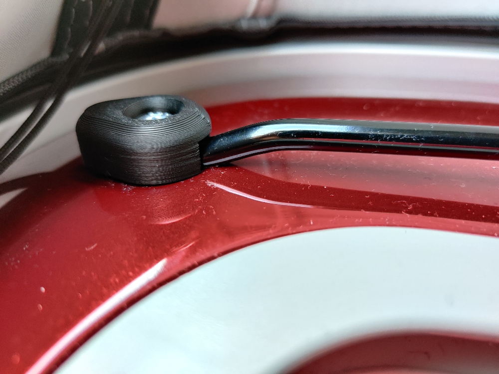

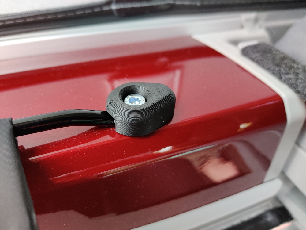

I measured the rail when out in the van this weekend. It stands a good 15mm above the metal base. For reference, the 12V socket is about 10mm.
Looking at the level of the mattress, I pretty much expect the CaliBoard to foul the rail. I'll see what 50 Nord say, but will likely go for it with the extra accessory and then report back here.
I have the caliboard and the storage net on my van , the additional fitting kit from 50 Nord consists of 4 “lugs” that you fit the bar which supports the storage net into replacing the existing ones on the van. In effect these create a shoulder around the bar which the board rests on instead of on the bar itself
What I have found is having the caliboard out renders the storage net redundant as you can’t access it during the night - but still useful in the day time when the bed is up

Thanks both, very useful info which confirms what I'd concluded. I'll order the extra option so I can keep the rails for daytime use of the storage net.
The video also shows sufficient space to route a cable for a heater down to the plug. This is exactly what I was thinking and will do the same (if required) rather than have the extra hole and hose to syphon off the diesel heater.
