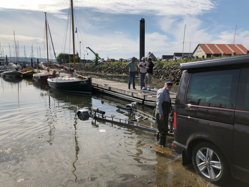

I have a 19’ trailer sailer, weighing about 1600kg. Launched by my 150 DSG Ocean no problem
Here I am at Largs
