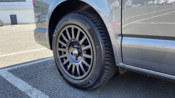

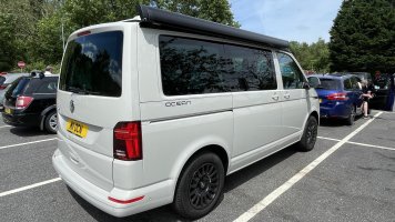

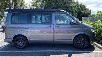

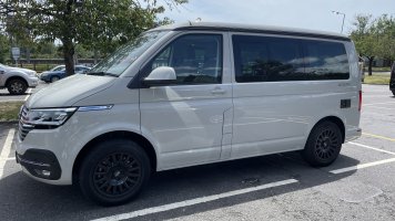

Isn’t a cali but standard set up on t32 LWB didn’t notice any extra protruding compared to when I had a cali on 235/55/17
Done 7000miles on them tyre wear was fine, Oz make great quality wheelsIMG_2130.jpegIMG_0805.jpeg
Done 7000miles on them tyre wear was fine, Oz make great quality wheelsView attachment 112948View attachment 112949
