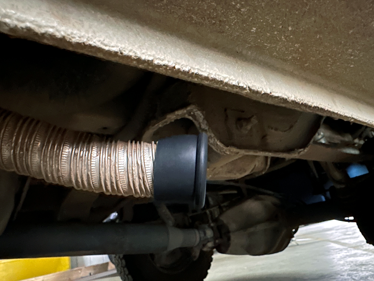

I swapped my undertrays for 6mm aluminium. No chance of these being bent going through water271a48a7-3068-4565-bcc8-b38e7613b7c9.jpeg
This is a cheap solution to help prevent your heater from water ingress:
Simply install the cover before entering deep water. Obviously the heater can't be on, and should be cool. Essentially hasn't been on for at least an hour prior.
