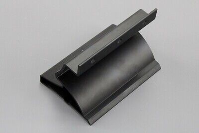

I’ve bought this it was the last one so thank you so much ☺️ I need one more and the ones for sale in this shop are this one-
Fiamma Adapter Brackets Trafic Vivaro Primastar for F45 F70 Awning 98655-854​
Do you think that’s the same ?

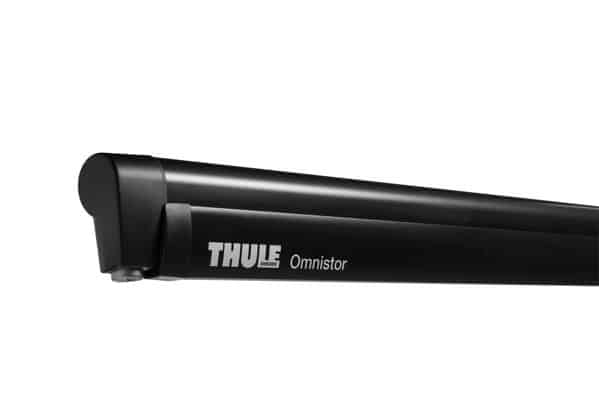

@Longtoothstan those won’t work unfortunately, the awning supplied with T5.1/6/6.1 is a Thule 5102. Local VW dealer will be able to order the rear for you if you can’t find it online
@Longtoothstan the part number of the front bracket you ordered is 7H7877238B. From some Googling, the part number of the rear seems to be 7H7877238C

Hi @Debcel I e sort the front bracket out I’m just after the back one now if you have one I’m in Newhaven
Here’s a pic of the one I’m afterimage-2022-06-12-15:30:37-356.jpg
