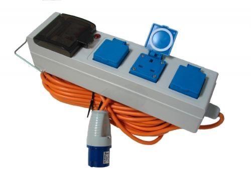

Few options…
- Portable 240v hookup:
- Permanent 240v hookup:
Or have a 240v retrofitted and have hookup in usual place, or, under the bonnet. It’s worth having 2 x internal sockets (1 in usual place & one in the boot). Cost £300 approx.
