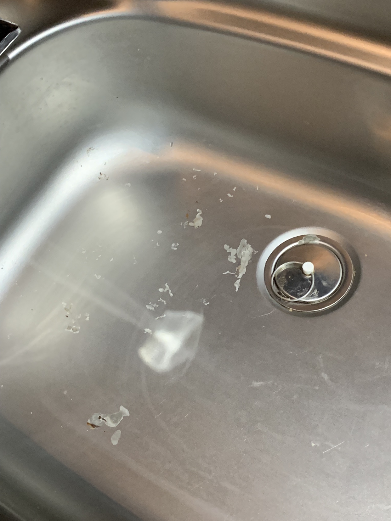

Posting this so hopefully no one makes the same mistake that I have.
I stored my Slidepod in December and in the sink I left a dry pair of gloves, a dry sponge, bottle of w/u liquid (closed) and a Carex soap dispenser (closed). The Carex leaked into the sink and it’s eaten into the stainless steel. I am just a bit gutted.
Anyway, the message is, keep Carex away from prolonged contact with ANY stainless steel things (it’s not specific to Slidepods, Dometic etc. Just ANY S/S) I believe it does mention this in the small print and I was careful to make sure everything was dry but the dispenser leaked
That looks like it would come off with a green scourer
Sadly not, it’s pitted/concave so it’s eaten into the steel.
If these marks are not too deep you could try polishing them out. Start with 120 grit wet and dry (wet) on a rubber pad or even better, if you have access to a small random orbit sander use that dry with 150 grit. Once the mark is almost gone move to a finer grit 240 for instance then get some polishing compound to finish off. Worth trying a small area first but as long as the mark is not too deep and the steel not too thin you should get an acceptable finish.
Are you going to do anything to it?
You could fill it and smooth off and then paint with an enamel paint as used to restore old baths.
Thanks - I think I’ll just see how much it annoys me (probably quite a bit) then replace the sink/hob unit. Enamel painting isn’t a bad idea but I’m not sure how that would look in keeping with the pod - love the stainless. I may try @Keith Smith ’s idea first to see if I can get it looking maybe 80%
